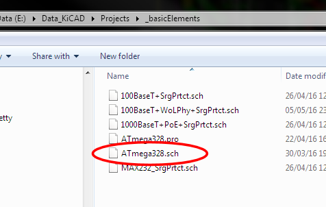

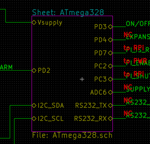

The sub circuitry part is possible via hierarchical sheets.
Just create a schematic with your reuseable circuitry and save that in a basic-schematics folder.
If you need that incorporated into your project you just copy the schematic into your project folder and create a hierarchical sheet within the project with exactly the same file-name as the sheet you just copied.
When asked if you want to populate the new sheet with the contents of the one that is in the project folder answer with YES.
