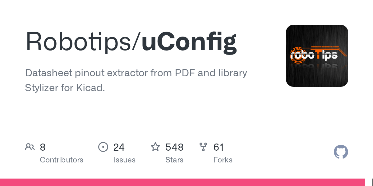

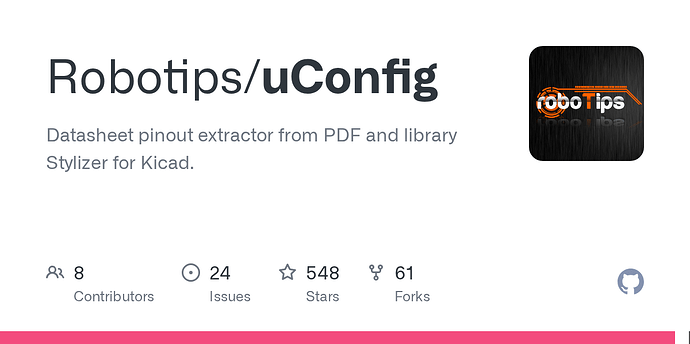

There is a uConfig tool that extracts pin information from PDF datasheets discussed here:
and lives here:
It took quite a bit of processing time to build, but I see there are a prebuilt Windows package and a snap package. I didn’t explore it further because my projects are hobby so I’m not fussed about having all the pin functions on the symbol. Some of those MCU dev modules could also use such a tool.
