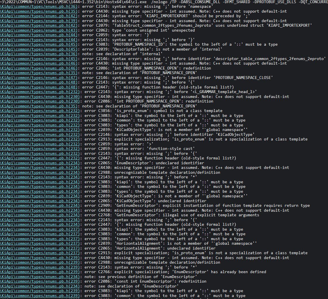

But I can’t use the associated header file because it’s full of errors, and it looks like the required protobuf header file isn’t missing.

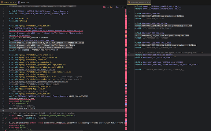

The strangest thing is that he can’t parse the protobuf version, he has to use #include “google/protobuf/runtime_version.h” before the kiapi header file, and if he compiles at that point, although he won’t throw an (
#error This file was generated by a newer version of protoc which is
#error incompatible with your Protocol Buffer headers. Please update
#error your headers.
) error, he’ll get tons of syntax errors.
I tried generating the kiapi source and header files separately using protoc command line, again lots of errors and no way to compile it into a library.
Since it compiles in the kicad source, that proves that the kiapi header files are fine. How do I configure my project to use these headers properly?

You will need to look at the differences between your CMake setup and KiCad’s. You also need to pay attention to the protobuf documentation; the warning it’s giving you is accurate. You can’t use a different version of protobuf between protoc and the libraries you’re trying to build and link against. Fixing this will come down to your package manager, probably.
