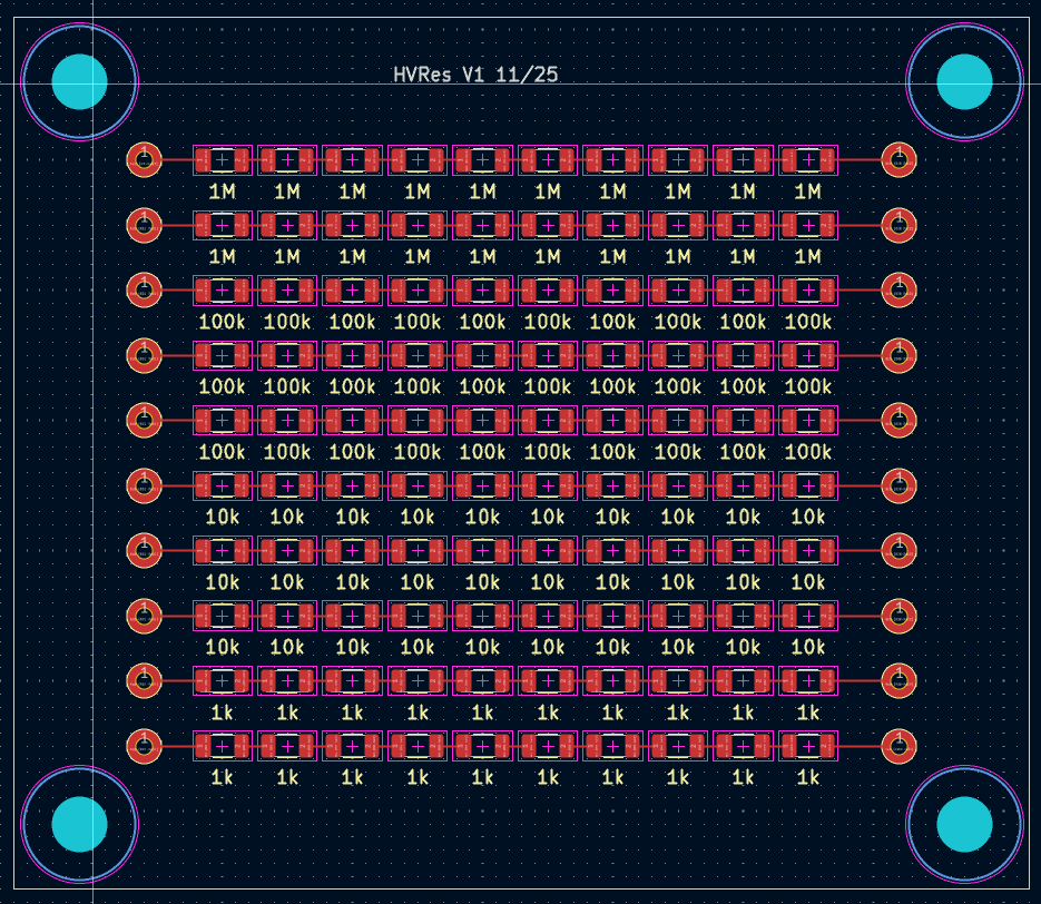

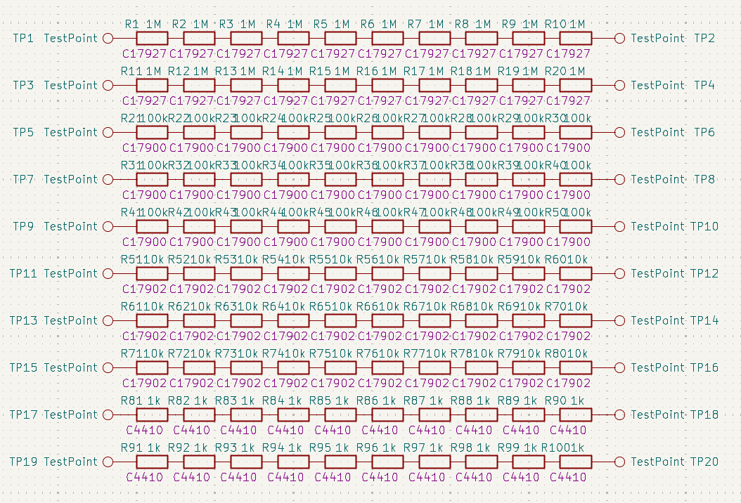

How to best automatically place 100 SMD resistors in the PCB without manually moving?
OK, maybe someone has an advice for a simple project. Working with some HV stuff I had the idea to populate a PCB with many 1206 resistors and use it as HV load resistors.
How to best place them in the PCB without manually moving 100 resistors?
I tried it with Claude Sonnet 4.5 working on a PCB file with the resistors already there:
make python script to edit the positions of resistors r1 to r100
use r1 position as top left reference,
arrange all resistors in a grid 5 mm spacing
r1 r2 r3 r4 to the right
r1 r11 r21 etc to the bottom
y direction is increasing downwards
make 10x10 matrix
which surprisingly took a handful of iterations. My guess is that the 500k PCB file is too large for Claude to work on efficiently. Not sure though.

Does it have to be scripting?
Is a standard Right Click → Align / Distribute → Distribute Horizontally or Vertically by Centre or Gap (whatever you prefer) not good / fast enough?
There is also the Array tool. Right mouse click > Select > Create from selection > Create Array.
