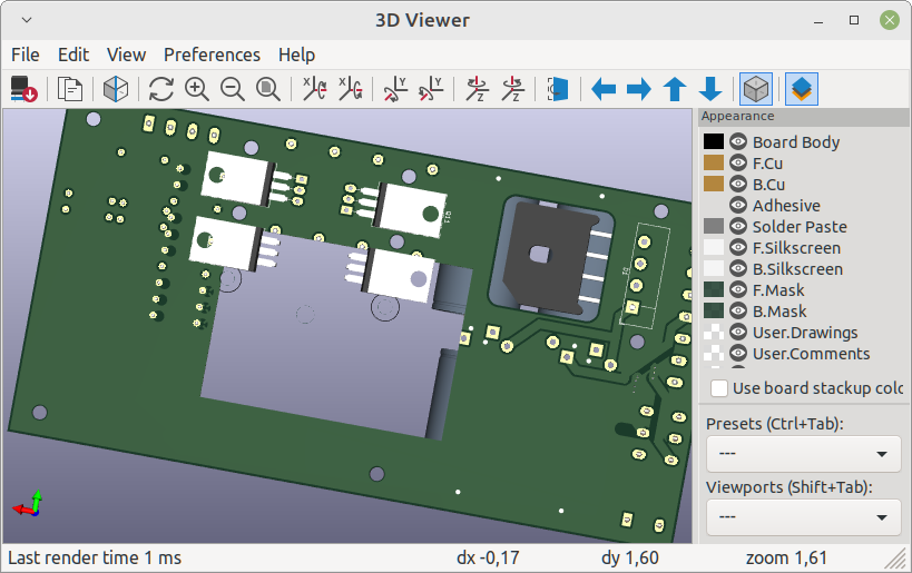

Internal cutouts made in Edge.Cuts certainly do work. Below a screenshot of a PCB with a cutout for a bridge rectifier, and I also added a rectangle on Edge.Cuts.

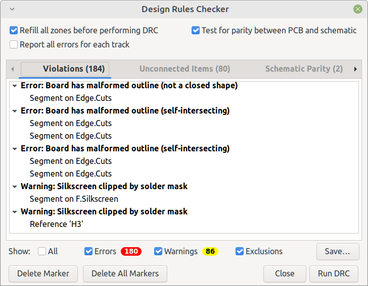

Also, if there are problems with Edge.Cuts, then DRC will catch them:
