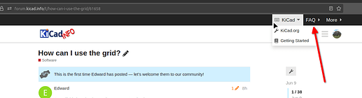

I usually get documentation by looking in the ‘help’ functionality of the software itself, or at the “about” item under the help menu which is supposed to contain helpful URLs.
docs.kicad.org was not among those URLs. It definitely should have been.
I got pointers from there at
www.kicad.org,
KiCad · GitLab,
KiCad Libraries,
Report an Issue | KiCad EDA,
and KiCad.info Forums
From the last of which I got forwarded here. But docs.kicad.org was not there. And Debian has a nasty habit of obeying copyright law which means that unless the (usually copyrighted) documentation comes with a free-distribution license, it doesn’t get packaged.

Install KiCad 9 and then complain about defects in the help menu - this is already changed. It will not be fixed in 8 or any previous version even if there’s a bug (unless you pay someone to backport it, of course). 8 and below are not supported versions any more.
Searching for “kicad debian” on any search engine gives you: Install on Debian | KiCad EDA. KiCad can’t force Debian to backport new versions to the mainline package repos, even if their version becomes unsupported - they just don’t do that. That is simply how Debian works as a distro.
KiCad docs are open-source and they are in the Debian repos - you presumably haven’t installed the the kicad-doc-en package (sub in your language/s as required) : KiCad - Debian Wiki.
