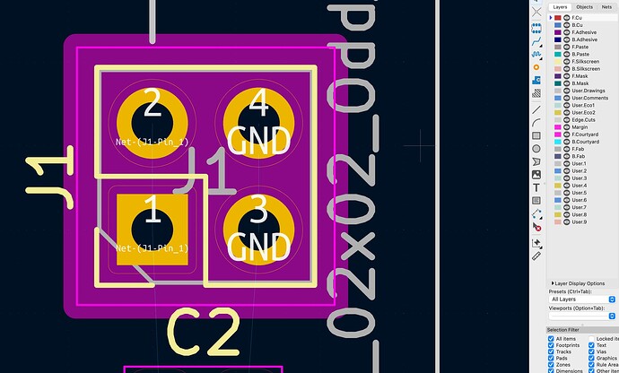

How can I flip a locked element in PCB Editor of KiCad 7 on MacOS?
How can I flip the locked item in PCB Editor? I tried to click F but it doesn’t however, the sub item if I select gets flipped. I want to flip the item upside down.
I want that 1 3 should be on top and 2 4 down.
In the Selection Filter in the lower right corner, the checkbox for Locked Items is off. As long as that is not checked, locked items will not even get selected, and they stay locked as they are. Whether you use the fruit brand of OS or some other computer is completely irrelevant in this regard.
I hope you realise that flipping means sending the connector to the other side of the board. If you want to keep it on the same side, then you need to do 180° rotate.
