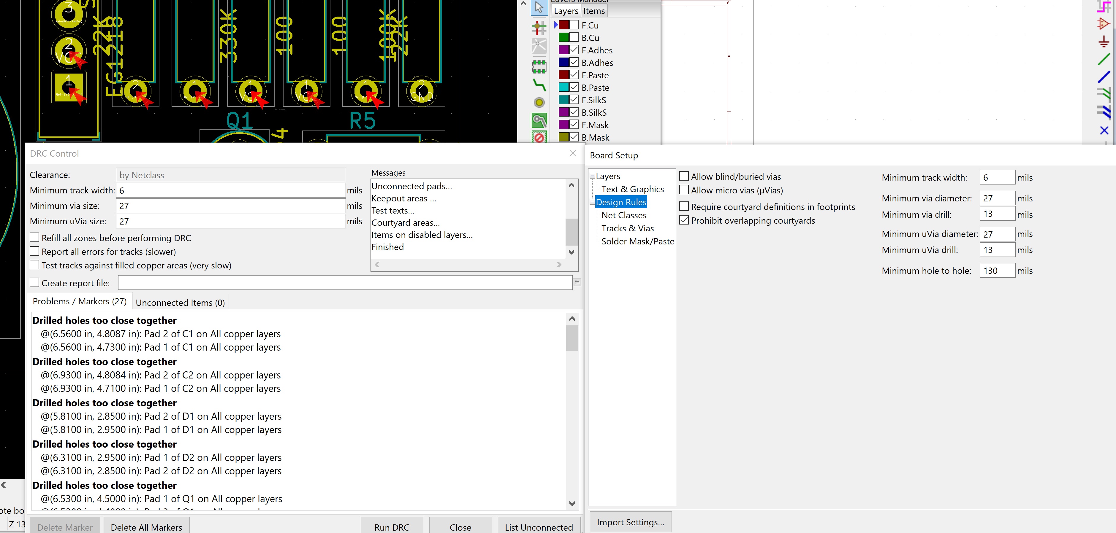

HI, Please see the attachment
screenshot of a layout. When running the DRC > "holes too close.’’ How to fix it? The Design Rules, DRC, arrows are attached in the picture, please look at it. Also, the version is 5.1. Thank you.
Your drilled holes are 100mil (0.1 inches) apart from each other.
If you reduce the Minimum hole to hole size to less than 100mil (or better yet, set it to your manufacturer’s spec), the error will go away.
Thank you. It worked!
Please set the minimum hole to hole value to around 10 mils. This should solve the issue.
