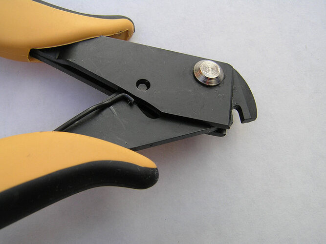

About de-paneling…
There are special pliers for that. Below a picture of a very simple (and affordable) handheld de-paneling tool. There are also more sophisticated versions that work on compressed air (or other?).
