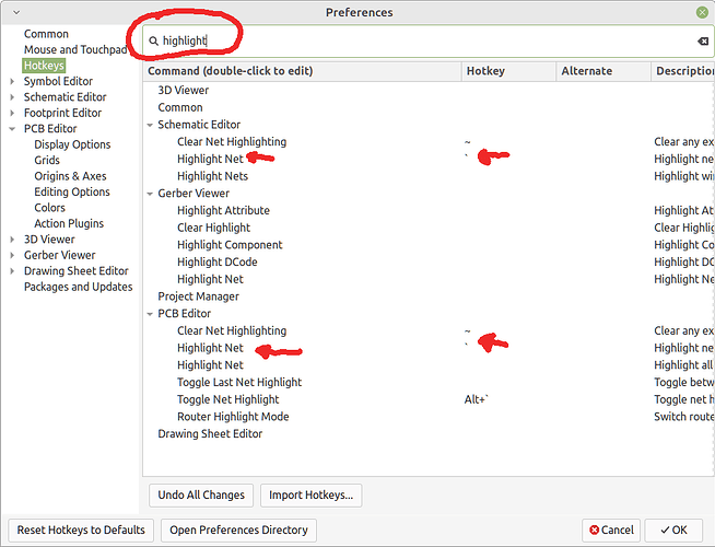

Sorry for this rather embarrassing question, but I cannot work without a solution for it:
I want to highlight all pins connected to the pin I just selected. Hotkey `doesn’t work.
It has been working in the default setup for decades, but s.th. has changes and I can’t find the correct config parameters.
Thanks in advance.

Are your hotkeys assigned properly?
does the backtick (`) key work at all?
You can search for hotkeys related to highlighting in the Preferences:
Also note there are (at least) two different net highliting tools in KiCad and they work slightly differently.

  • try to assign a different hotkey. On some systems the backtick character does not work
  • explore the global preferences. Look especially at Preferences–>pcb editor–>editing options–>left click mouse commands (set CTRL==highlight net action)
  • be sure to have “Pads” and “tracks” enabled in the selection in the bottom right corner

as confirmation: highlighting works for me:
  • CTRL+left click (after enabling in the global preferences)
  • hotkey also, but not the backtick (as mentioned, on some systems this character doesn’t works. Depends on windows language/keyboard settings).

Thanks team, I was able to make it working, with the right preferences and an adapted handling.
