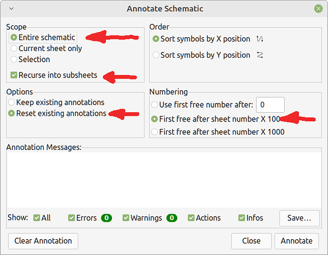

  1. Many actions (for example, updating the layout from the schematic) give the same error message: the schematic is not fully annotated. I have looked for missing annotations, but can’t find any. It would appear that the error is related to the two replicated parts of the layout (two half bridges with largely the same layout). When I delete the replicated hierarchical sheet and re-copy the original one, the error is gone. But just once. Forever after that, the error returns and persists until I repeat the operation of deleting the replicated sheet and copying it afresh. What am I doing wrong here?

Annotation is still a bit of a mess in KiCad itself. Ideally, KiCad should not bother about annotation at all, because it uses UUID’s internally, but for now it’s a thing we have to live with, and annotation has to be correct for KiCad to work properly.
Most of your problems are indeed related to the annotation, and tho the duplicate sheet. At the moment, you have a “Q3” on each of the instances of the sheet, that means you have two transistors with the same RefDes, and that does not work. You have to re-annotate at least one of those sheets, but there are more annotations. It’s easier to simply do a global re-annotate, and then add the page numbers too:
After this, the annotation problems (and the duplicates) have been solved. Do note this does not change the mapping between schematic symbols and PCB footprints, provided you keep the Re-link footprints to schematic symbols based on their reference designators checkbox OFF. This should only be turned on for some special occasions.
