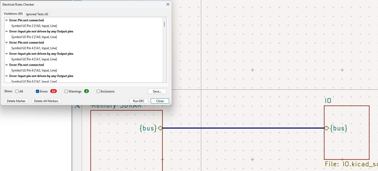

Hierarchical label {bus} has no matching sheet pin in the parent sheet
I’m new to KiCad and currently using version 9.0.2 (release build). I’m encountering an issue when creating hierarchical labels. I’ve uploaded a sample schematic to schematic
since I can’t share the actual one, and I’m experiencing the same problem in the sample.
Could anyone advise why the ERC is giving me this error?
Thank you in advance!
Mohammed

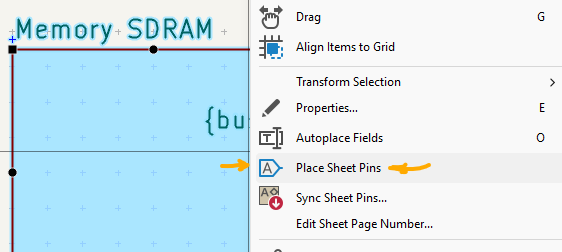

I fixed some of the issues . . .
I’m not sure what the difference is but I added new Sheet Pins using this option . . .
Right click the sheet then Place Sheet Pins
Are you aware that KiCad V9.0.3 has been released almost a month ago?
Perfect, Thank you very much!
This fixed the issue
