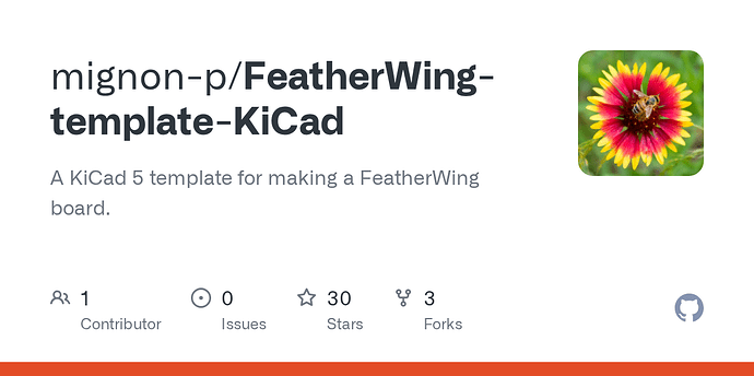

You may benefit from using a template for this board - a quick search turned up this which includes a link to, but like all things, you probably need to verify that it meets your needs.
and the repo
Thanks @John_Pateman I actually started using labels but when I was working through ERC errors I thought it might be best to connect directly.
I’ll checkout the template you found (thanks for that!). I actually took Adafruit’s schema and pcb for one of their Feathers and deleted everything I didn’t need. This was especially useful in the pcb design to ensure the edge header holes and the board edge cut would match their board…so I’m not starting from scratch…
