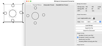

Re: Drawing the DXF can be done in FreeCAD, Inkscape, LibreCAD…etc
Screenshots show it drawn in FreeCAD then DXF imported into PCBnew. Also shown in Inkscape then used in Image-Convertor and footprint edit and placed in PCBnew
FreeCAD
Image-Convertor
