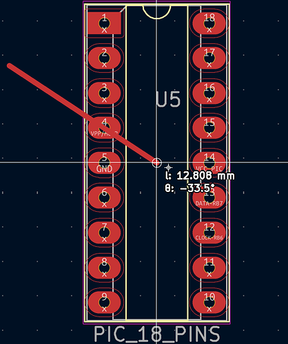

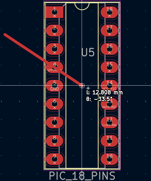

Kicad doesn’t do this for you (and as far as I know, other tools don’t either). If the PCB contour is a regular figure (for example a rectangle) I do this: Trace diagonals using a drawing layer to determine the board’s center, select this layer and move the component to the center in order to get the snap. Hope it helps.
In KiCad V4/V5 you were not able to move absolute origin so I decided to work around it. In most cases I have absolute 0,0 in my PCB center. As grid origin is typically also there then I had never any problems with snapping to PCB center.
