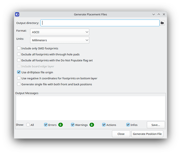

Next, I decided not to perform the DRC check after creating the panel. Now comes the question of creating production files for the panel. In theory, this can be done using KiCad in the Production files menu.(Gerber, drilling, component location, etc.)

  1. How can I create a command in the bash console to get the component location files for NEODEN YY1 and is it possible to immediately get the gerber files, drills for the PCB manufacturer and the steel stencil manufacturer through the command in the console? If this is not possible, then the next two questions are!
  2. How to create a command in the bash console to get the necessary gerber, drill, etc. files for panel production. Or can they be obtained through KiCad?
  3. What files are needed to create a stencil for this panel?

It sounds like you need KiKit help and not KiCad help so much . . .
Thanks! I asked a similar question on the kikit forum, and I’m waiting for an answer there. Please tell me, is it possible to get the same results without using kikit, but using KiCad tools? will you just have to draw the panel manually?
I’ve played a little with KiKit because KiCad doesn’t support panelisation natively . . . I’m sure there are ways to do something similar in KiCad but it will be a kludge.
