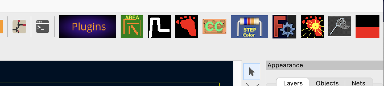

Though I’m not using v8/v9, so I can’t confirm but, even with my v7, I still use the Old method of manually placing my Plugin’s into the Plugins folder… very reliable and no need for Meta/etc…
Have you tried do that?
