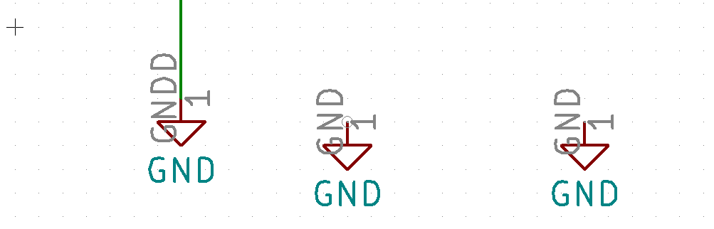

And for these symbols to work you need to make sure that in pin properties (right click the pin) you DESELECT the ‘Visible’ option in ‘Schematic Properties’… otherwise they don’t work.
Hi Joan,
I’m using regular ground [GND] from KiCad power library, my question is why there is a pin showing in the ground symbol?
The visible option is deselected , is there is good place to review how is the grounding connected ?
You probably have activated the “show invisible pins” mode.
Thank you so much , you are correct
