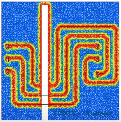

This is why ground planes work so well: it’s a convenient way to ensure that there’s a return path parallel to every signal trace. But note that interruptions to the ground plane can break this. This is dramatically demonstrated in the following image with signal lines going straight across the board, but a large cut-out in the ground plane on the other side: you can see that the signal returns can’t follow the traces, instead having to go a long way around. This gives you a big gap between the signals and return paths, which is a big EMI field that can both interfere with other things and is much more subject to interference from other things, degrading the signal integrity.
Note that ground planes should not be confused with ground fill (many people do this): as you can see from the above a ground fill that’s heavily broken up is far from a ground plane and in many cases will provide essentially no help at all for signal integrity, or even degrade it.
The issue with interference in AC signals is when two separate signals share (usually just partially) a return path; this can cause interference between the two, almost as if the original signals were partially sharing their signal paths. You can see a perfect example of this above: the three signals all share a common ground return path around the cutout in the ground plane.
