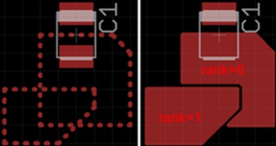

I would like to have two ground pours, one digital, one around analog components attaching to ADC uC pin.
I know how to create two separate pours, I connect them in one point using 0ohm resistor.
However, in Eagle I could use rank and the pours were behaving smartly, I got cut-ins according to rank, the pours were reaching to their pins/pads.
Can I do something like this in Kicad? Maybe there is different philosophy to handle two pours?
Picture snatched from dangerous prototypes website :slight_smile:

You can do that by adjusting the “priority” setting of the zones, see the documentation:
http://docs.kicad.org/en/pcbnew.html#_creating_a_zone
Thanks Andy! I was not aware of that. I will look into it very closely.
