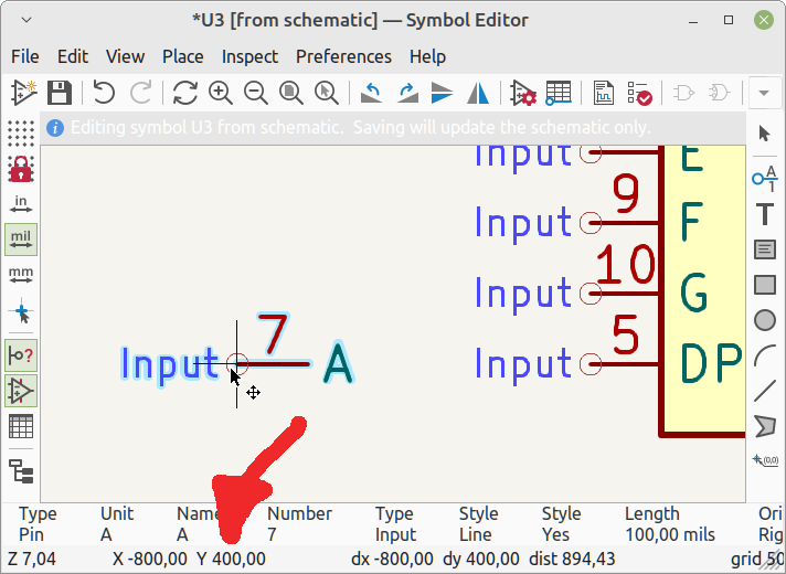

I’m trying to create a new library symbol while doing my first KiCAD design. I can right click, select grid, and pick a grid size (I’m choosing 100). The new grid size constrains cursor placement to the desired grid.
Now when I try to place a pin, the effective grid size reverts to 50 despite showing 100 checked in the context dialog. Is this intentional? Is there a different grid setting to pick for pins somewhere else? I’m trying to place pins 200 units apart.

I figured it out. Under Preferences → Symbol Editor → Grids → Grid Overrides, there’s a checkbox for “connected items” which appears to include pins.
If I uncheck that, grids behave as I expect. I want to widely space pins so that there is some room for net labels, passives, etc. between them.

Working with grid 50 don’t block positioning pins with bigger distance. I typically place one 8 bit port pins with 100 distance between them and left 150 to first pin of next port.
I strongly suggest you read the KLC:
For pins, go to section S4.2
In summary, the active pin ends (the ones you connect to in the schematic) should be on a 0.1" (100 mil) grid. The symbol graphic itself can be anything.

I would leave the grids alone and simply look at the coordinates while placing pins in the symbol editor.
