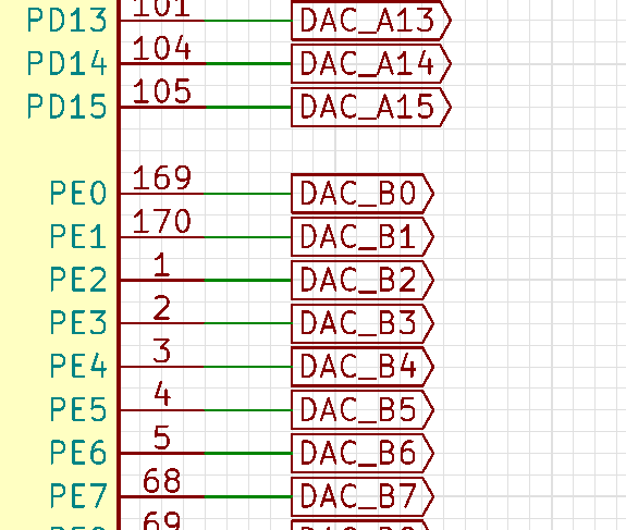

Hello!
These extra lines all over the place are driving me crazy and the only way I have of getting rid of them is to hide them.
Just for your info. The default for lines instead of grid is really ugly. I don’t remember the default grid color, but here is how it looks with (128, 128, 128).
Indeed, you have lines everywhere and sometimes lines are as thick as traces.
The setting I use for the grid color is (48, 48, 48). In this case, the result is as follows, around the same area.
The good thing compared to dots is that whatever the scale, you can see it. And if you tune the grid color good enough, it doesn’t harm the PCB view. For grid color, go to the layer manager on the right, choose the item pane and double click the square facing the grid checkbox.
Beside this, another advantage of lines is that you can see both grid and subgrid. In the default grid color, of course, it’s a bit too visible.
In gray(48, 48, 48), it looks like this, and you get both grid and subgrid in different thickneses.

Hello!
Just for your info: the same adjustment is now possible in 5.1. I just downloaded it to have a test run.
The original setting was quite dark. I have set the grid gray to (240,240, 240) and the result is as follows:
Grid
It would be better with non-tansparent labels but at least it works.
