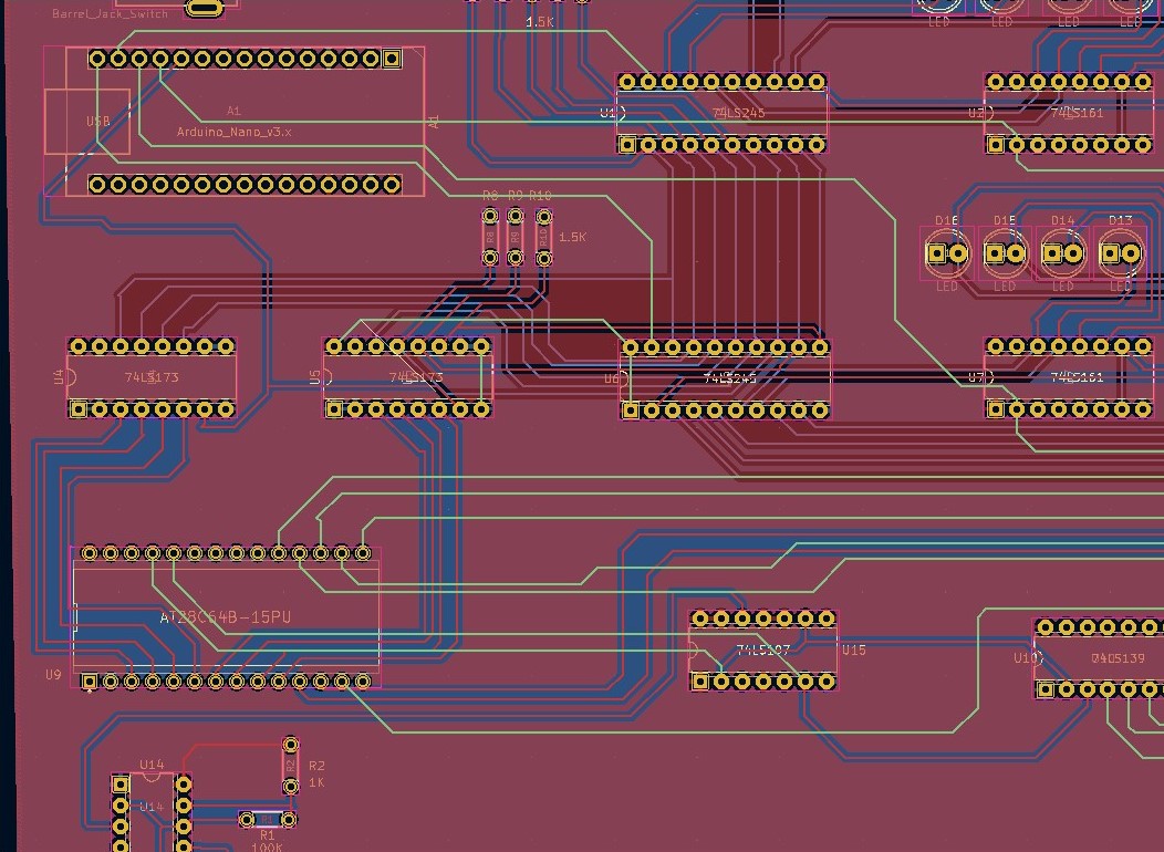

Hi there, I have 1 component that shows a ratsnest trace that is connected from the power pin to nothing. Although the pin is shown to be connected to to the power plane, DRC reports it as unconnected. I have tried everything to get rid of it. even if i connect the pin to another VCC pin, the ratsnest trace remains unimpressed. I have not been able to make sense out of a similar post. Using version 6.0.11. See image. Any help would be wonderful.

May we have a more complete picture of the surround of u5?
Your VCC plane have to have two separated islands.
To one another he probably can. He should try to connect all VCC pins with track to find that he can’t.
I have a blown-up view having connected pin 16 to another VCC pin. As you can see the unconnected trace now is connected to this new trace. I also include an expanded view to show some of the surroundings. This shows that there is another 74ls173 which does not display this problem.

Here is your unconnected VCC plane island.
It is filled as it has connection to U9 VCC pin but it has no connection with rest of VCC plane and it is what KiCad tries to tell you.
It is not a problem related to any IC but a problem of lack of connection at PCB.
You are a genius. I connected the pin to a VCC pin on the island and the problem went away. Thanks a lot.
