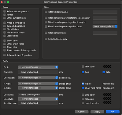

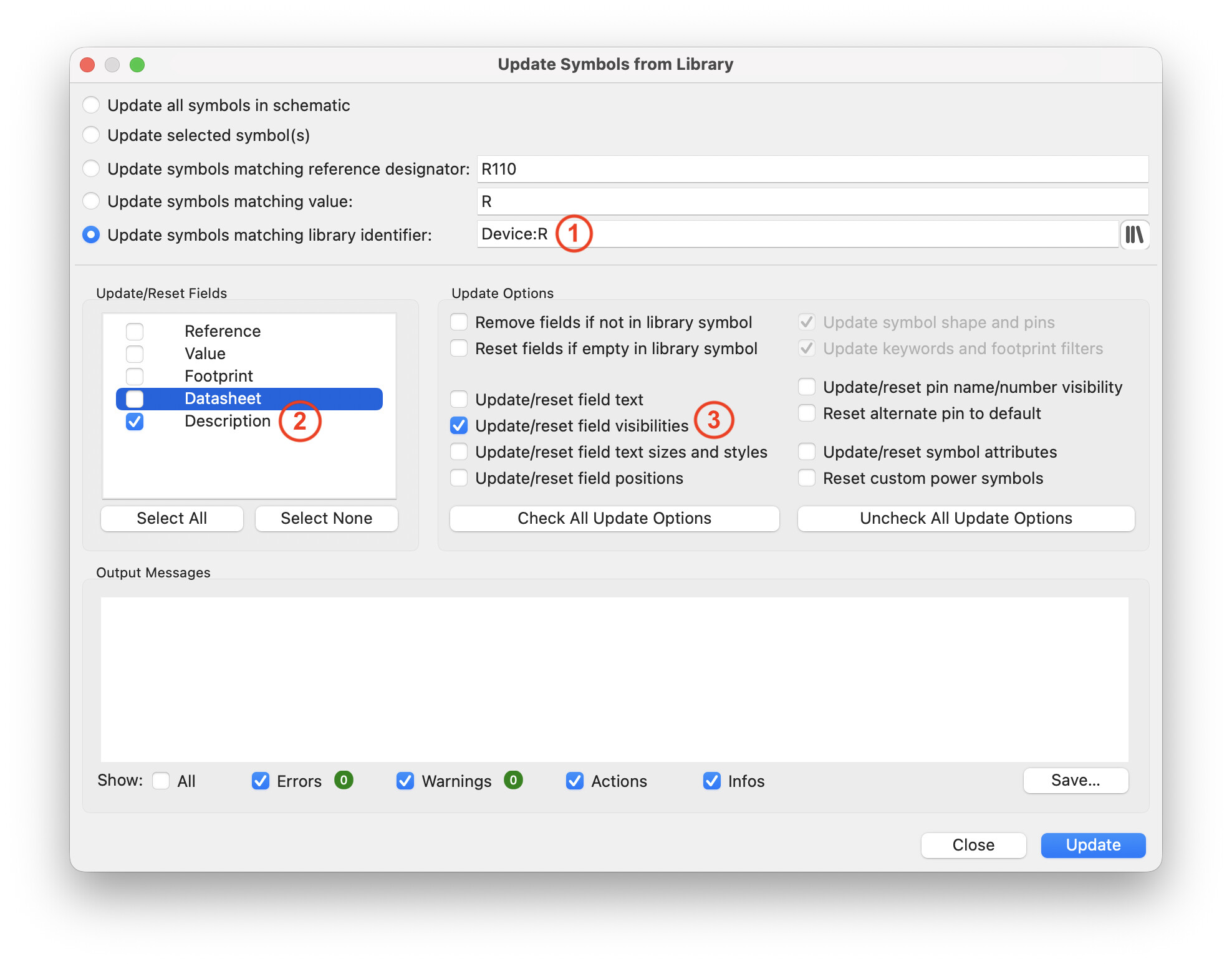

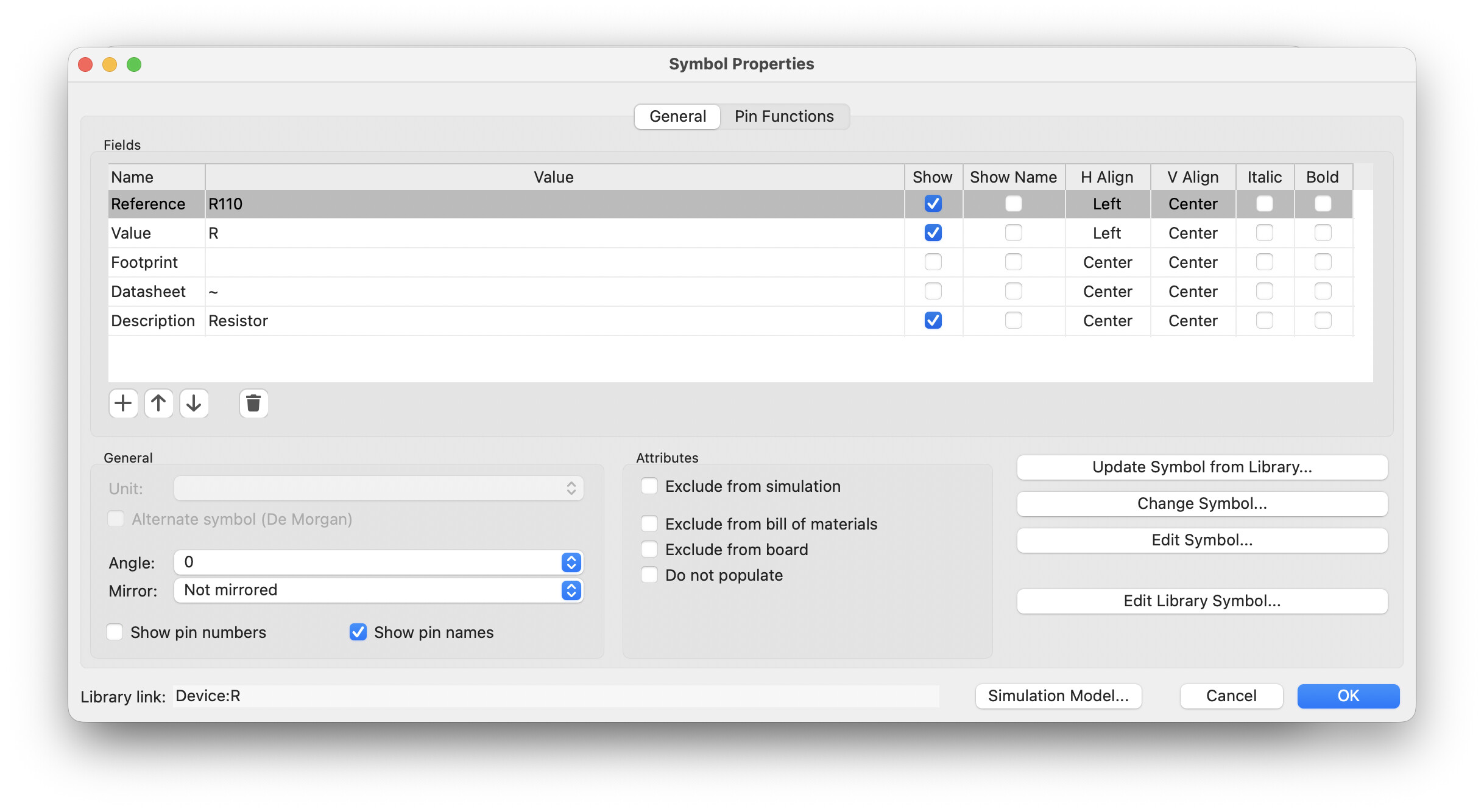

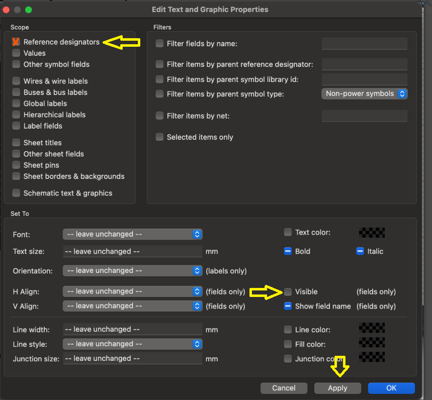

Probably due to my missing experience I clicked something in the beginning of creating a schematic which led to the fact that all symbols show their description text (e.g. “Resistor”) in the schematic. Where can I switch off this behaviour by one strike?

Try:
Schematic Editor / View / Show Hidden Fields.
“Show hidden fields” was not activated. Also toggling it didn’t have any influence on Description Resistor being displayed at some resistors.
Maybe I had enabled this with the first resistor I created and then it got propagated with every copy I placed. Meanwhile I removed the property manually.
