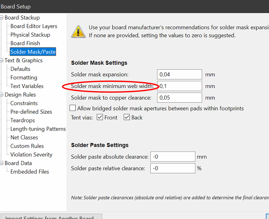

But I noticed when I change Solder mask setting in board setting, Minimum web width to 0
the gerber output is correct. Only zero value works.
Does it make sense if the geometry is showed in PCB Editor and not in gerber files?
this is setting I’m using for gerber output

good pictures, good example. Looks really like a bug, provoked by the "“solder mask minimum web width” setting.
Would be good if you open a gitlab issue (Kicad board editor–>Help–>report bug report) and attach there your example and the pictures.
Normally not, gerber output and pcb display should be the same.
But there is a exception. All settings in the shown “Board setup–>Board tackup–> solder Mask&Paste” are only used for postprocessing the pcb prior to the gerber generation. So these settings (mask expansion, removal of mask < minimum web width) are not reflected in the pcb editor.
