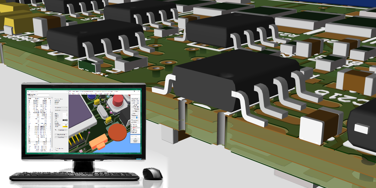

For other broadly related work on 3D visuals inferred from Gerber files in, see this
  • this is a ‘3D viewer’ gerber in.
https://www.eevblog.com/forum/eda/take-a-look-at-my-newly-improved-pcb-viewer-gerber-viewer/
https://www.zofzpcb.com/
