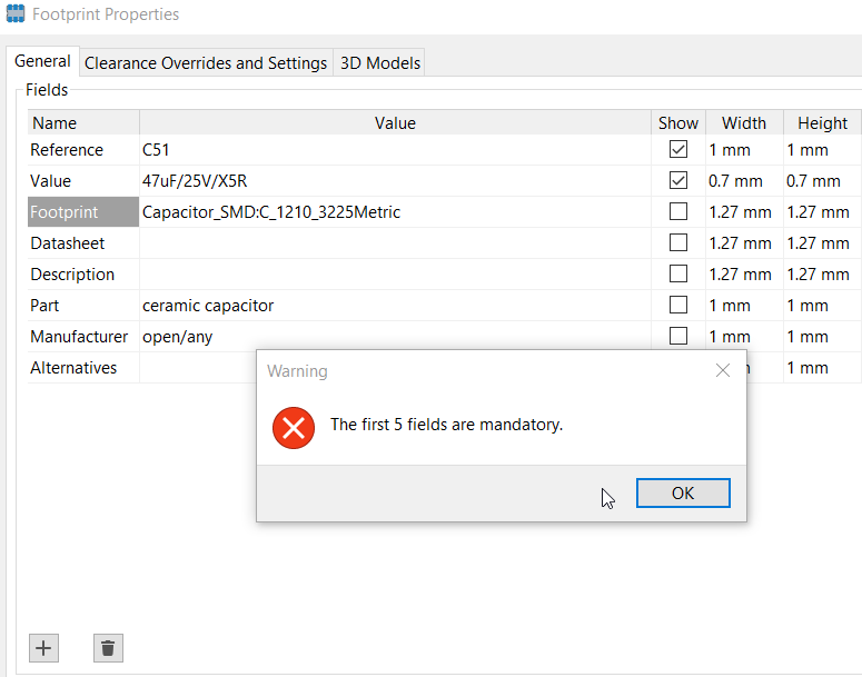

@Bobz (1st post) in my KiCad version I could only find a “Footprint properties” window and not “Footprint value properties”. This could either be because I am using a different KiCad version then you are or I couldn’t find the right path to “Footprint value properties”. In the “Footprint properties” that I am seeing, the “Footprint Value” visibility (Show) checkbox ist already unchecked, but the problem seems to exist.
Could you kindly let me know which KiCad version are you using, please?
I have attached a screenshot of “Footprint propperties” window below. Am I looking in the right place?
@RaptorUK: As you can see in the screenshot above, the “Footprint value” text in my case is on layer “B.Fab” But if I turn B.Fab off, not only does the long text disappear but also the whole footprint including the “Reference” and “value” parameters.

This happens because the mandatory Property fields are actually text items, as you can see in the dialog:
(Trying to delete one shows the message dialog.)
These settings are the default in the KiCad libraries: only Reference and Value are visible, the rest are invisible. I think you have somehow changed the “Hidden text” Object visibility in the PCB editor, it should be disabled by default. That’s a handy way to see all the invisible texts, but naturally most of the time you don’t want to see texts which are marked to be invisible.
