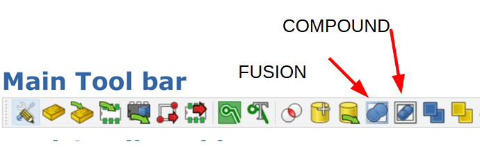

I’ve imported a project and it appears fine. When I do PART—Boolean—Union, to add hex posts, the color of the Fusion is black/white.
Is there a way to retain the original colors?

have you tried the StepUp fusion button, or the compound one?
it sould keep the colors

Thank you! That worked great.
