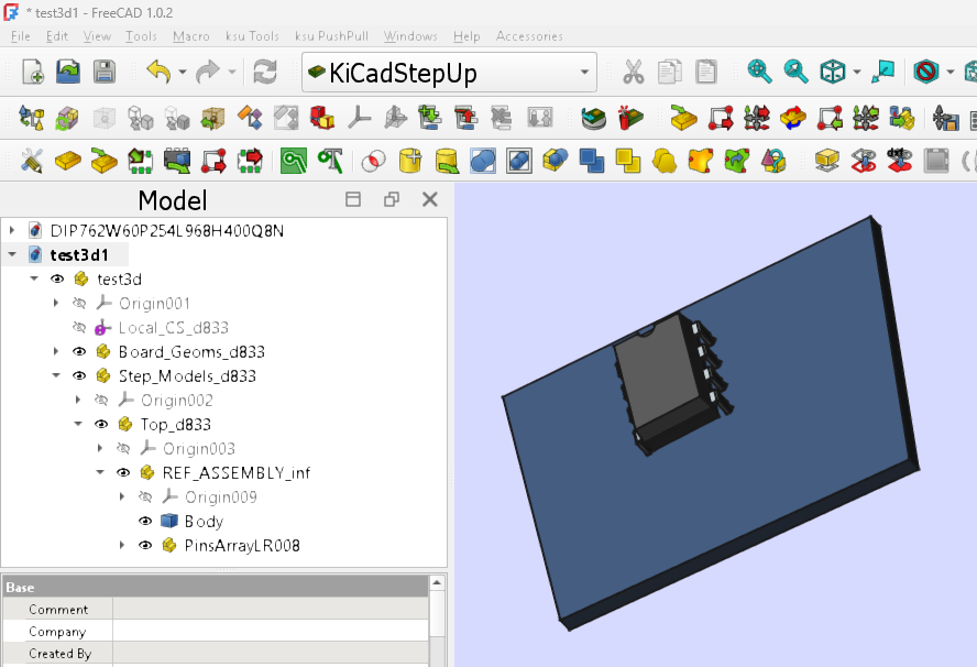

Hi @voidtrance
With your board I can reproduce the issue… I’m going to investigate.
normally when saving a path in kicad, inside the ‘kicad_pcb’ file the path get ‘coded’ with ‘/’
(model "C:/Users/Mitko/Documents/KiCad/Libraries/SamacSys_Parts.3dshapes/LTV-825.stp"
in your ‘kicad_pcb’ file I get instead the path ‘coded’ with ‘\\’
(model "C:\\Users\\Mitko\\Documents\\KiCad\\Libraries\\SamacSys_Parts.3dshapes\\LTV-825.stp"
It is strange that if I modify the ‘kicad_pcb’ file adding my internal path, I still get the ‘/’ instead of the ‘\\’
