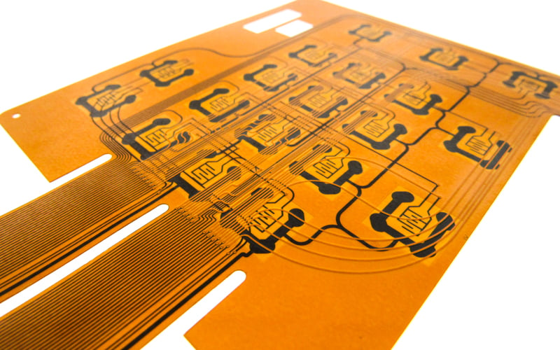

Also, consider dome switches. These domes are available in different sizes and “strengths”. Some manufactures also have kits with a variety of them to try them out.
The (random) picture below looks a lot like standard flex PCB used for switches:
I have not searched long, but there must be plenty of other examples floating around on the 'net.

It could be used as a capacitive pad, but in my case I’m hoping to use a similar footprint rotated at 90 degrees, on a second PCB. The first PCB will be a flexible one (they are quite cheap now on J-L-C PCB), and there may be something in between to act as a spacer (it is just a half-baked idea currently, I will need to experiment!).
The hope is that it will then act as a membrane switch, with the mesh of the horizontal and vertical copper allowing good contact pressure. If this works, then the silkscreen on the other side of the flexible PCB could contain the text legend for the button.
The end result could be like the flat buttons on typical microwaves for instance.
A different design could use the metal snap domes, for a tactile feel (I need non-tactile silent buttons for my application).
