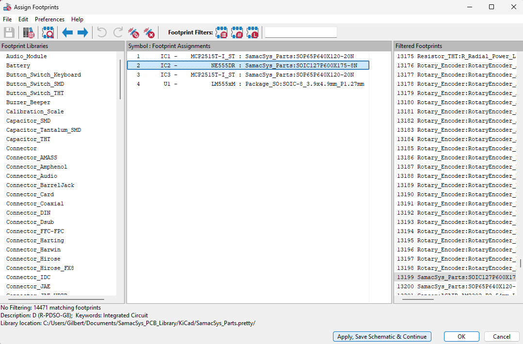

Meanwhile I’m trying to import components using SamacSys. I got almost to the point where I was hoping to get, but I’m still not there. I figured out how to convert the legacy library format supplied by SamacSys to the current “pretty” format. And I found out how to link a footprint supplied by SamacSys to the corresponding symbol. Now I can transfer the schematic to the PCB editor and get the expected footprints. It’s annoying that this requires so many extra steps ;-(.
What still doesn’t work: When I select a (SamacSys) symbol in the library, I don’t get the footprint for that symbol. I always see “Invalid footprint specified” despite the fact that I linked the footprint to the symbol and I get the footprint in the PCB editor.

Your footprint reference looks incomplete. Show us the footprint library that contains it. It will be of the form library:footprint
I did assign the footprint to the symbol. Makes no difference.
What else can I do to fix this?
The symbol information seems to ignore the change I made???
The prefix “SamacSys_Parts:” which is shown in the footprint assignment is not shown in the symbol properties.

Footprints can be associated in the symbol which will be the default footprint. It can also be overriden by the Assign Footprint action while editing the schematic, in which case the association is in the schematic, and the symbol is not altered.
Here is the section of the documentation you should read to understand the ways of assigning footprints.

I followed the instructions in the doc: select the symbol in the schematic, select “properties” and made some changes to see what happens.
When I change what is shown, the change immediately affects what is shown in the schematic (in my case: name and value). The location of the footprint was correct.
Saving and restarting didn’t help.
Tried another route: select the symbol again on the schematic, select “Edit main Fields / Edit footprint”. Then selected the desired footprint, which was clearly shown. Saved. Restarted KiCAD. Still no success. Could it be a bug?
Screenshot of the first route I took…
Finally…
Had to go to the symbol editor, select the component’s symbol, migrate the current SamacSys library to the current KiCAD format (kicad_sym), then go to Symbol properties and use the footprint chooser to select the correct footprint for this symbol. After that, the “SamacSys_Parts:” prefix is finally included in the footprint property for the symbol.
