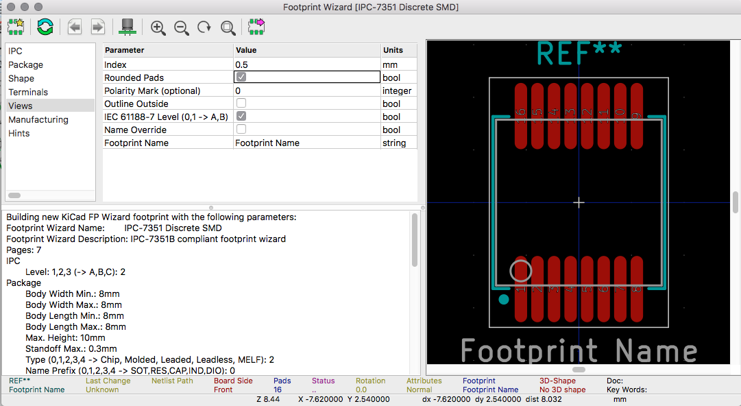

I have also come across this website https://elnet.ch/ where the author has written two ‘wizards’ for IPC7351 compliant footprints; [edit] one for Discrete SMD (SOT/RES/CAP/IND/DIO) and another for Leaded/Leadless ICs (downloadable here)
I did briefly try these out a while ago and there were some problems running them - I managed to get then patched up but couldn’t get in touch with the author. Since then they seem to have done some more work on them & they now seem to be working OK without any patches.
I have not tried any of these footprints in production but I have not seen any glaring errors.
