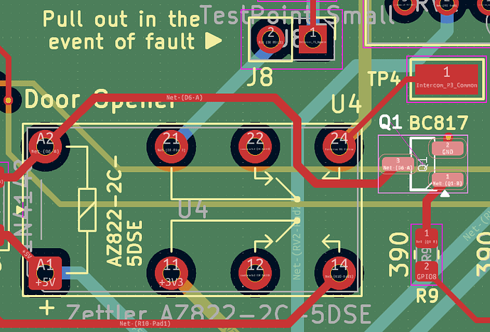

I indeed have a project with a way more complex PCB. It actuates the door opener of my intercom system and notifies me if someone rings the bell.
This PCB works almost perfectly fine since a few months. There is only one magic thing: In all these months it happened one or two times (not more) that the door opener was actuated though noone has clicked the actuation button in the software (HomeKit). I could verify this in the logs.
Do you think that a transistor can be accidentally turned on by ESD or is this likely a different problem?

BTW, on your pcb, Q1 pin 2 is not connected?
Pin 2 of Q1 is ground, here a larger photo:
The transistor is not driven by a push button, but by 3.3V @ 330 Ohm (GPIO8) from an ESP32-S3. So I was a bit perplexed, since this event happened one or two times in a few months.

Well, you have a npn bjt, driven via a very low-valued resistor. The npn will start to turn on with a base-emitter voltage of around 0.7V or so. Some glitchy noise on the esp pin may be enough, or some noise pickup in the trace. I have not used a bjt switch in quite some time but the preferred way to connect is to also add a base-to-emitter resistor and you have a voltage divider that improves noise immunity.
So some simple math: Find out the required collector current – you are driving a relay coil of some sort – let’s just call it 100 mA. Find out the minimum beta (dc gain, or hFE) of the transistor at that current. From the datasheet it says the device has at least a gain of 250 at a collector current of 100mA:
Sooo, this means the base current needs to be at least 100mA / 250 = 0.4 mA.
Let’s say I put a 1k resistor base-to-emitter. At a minimum 0.7V Vbe turn-on, you will have 0.4 mA going into the base, and 0.7mA going into the 1k, which means the series resistor will have about 1.1 mA going through it. Let’s make that series resistor a 1.8k just for grins, so it will have (1.8k * 1.1mA) about 2 volts across it. Add in the 0.7V on the base – this means the esp pin needs to drive up to about 2.7 volts before the transistor turns on, instead of less than a volt as you have it now. These numbers are just approximations, but gives you a starting point.
I would replace your 330 ohm series resistor with 1.8k and tack on a 1k base-to-emitter. That will improve your turn-on sensitivity a fair bit, and is an easy tweak.
Since relay turn-on (and off) time is likely not a concern, you can add a little cap base-to-emitter as well to filter glitchy stuff.
Did your esp reboot when the events happened? That could also do it (and may be the root cause), as the pin may have sourced enough voltage as it went to a sort-of-open-ish-internally-pulled-up state during reboot.
Thank you! I will try that. No, the ESP32 didn’t reboot, it stayed normal.
