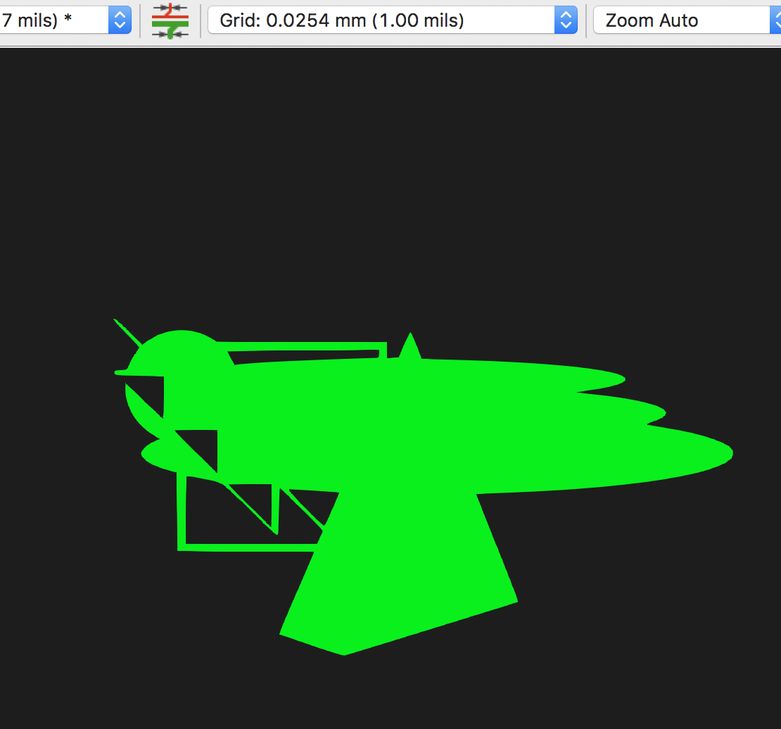

I’m trying to edit a logo on FootPrint editor, since the Image Importer is just horrible, and I have to correct all its errors.
But I can’t find a way to DELETE the corners.
is there a way please?

Indeed, you seem to have nice bezier curves there where the round dots are control points for changing curvature, not corners.
yes nice bezier … it’s pity the original picture has rectangles up there :smiley:

But when a PNG is imported into kiCAD, the transformation KiCAD makes is horrible. Although enough usable. but with pain, to adjust all the segments.
For the SVG I just got these missing hollow zones.
Please check these:
Imported vs Original
SVG in PCBNew by Import > Graphics
PNG imported with Image Converter by KiCAD
Very not precise.I refused to manually retouch because it’s small and it’s not a big issue, but there is
