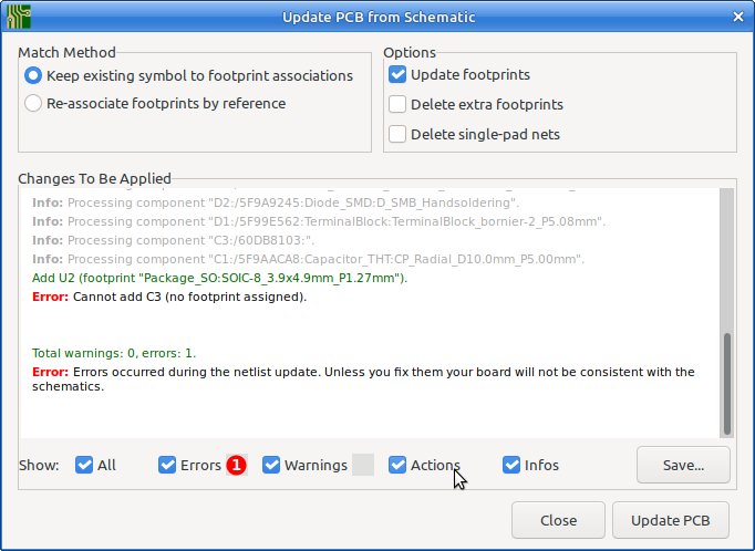

Eeschema / Tools / Update PCB from schematic … however, puts the “netlist” (As in a list of connections between pins) directly from Eeschema into Pcbnew.
This, and your use of the 3D association file suggests you are trying to use the wrong workflow.
With a normal workflow the schematic is the reference, and after you’ve drawn the schematic, you assign footprints to the schematic symbols, and this is what creates the association between schematic symbols and PCB footprints.
If you’ve done that, then Eeschema / Tools / Update PCB from schematic … (Or [F8]) puts both the whole netlist and all footprints into Pcbnew.
You can not create the association between schematic symbols and PCB footprints with the footprint association file.
Normally the association between schematic symbols and footprints is done via unique number (“Timestamp” in KiCad V5.1 and UUID in KiCad-nightly V5.99), and this is done implicitly when you create footprint links in the schematic symbols.
If it is a simple schematic, it’s easiest to simply empty the PCB, then do the footprint assignment in the schematic and do the Eeschema / Tools / Update PCB from schematic … (Or [F8]) once more. Pay careful attention to any lines with red text. Those are important errors. For example in the screenshot below, a new footprint (U2, a SOIC IC) is added to the PCB, but C3 can not be added to the PCB because it has no footprint assigned yet. You should fix that in the schematic untill you have no errors anymore in this step.
