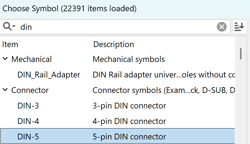

I recently installed KiCad 9.0.6 and have started using it to create a schematic/pcb for a project of mine. One thing I’ve run into a few times is not being able to find a component in the libraries. In this case it’s a 5 pin DIN jack, but there have been others.
One does a person do in this case? Are there particular tricks to searching the libraries? Is there somewhere to go download components?Is the user supposed to just build the symbol and footprint?
Talking about “component” is ambiguous when KiCad libraries are concerned. Symbols and footprints are separate. Finding a 5-pin DIN symbol is easy, just write din to the search field.

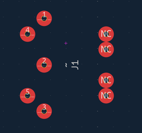

I’m trying to create a footprint for a PCB 5 pin DIN connector, but having issues with holes that have no connections. Specifically the tabs in the front of the connect that are just used for anchoring. KiCad complains about missing nets. I will get it figured out eventually. :slight_smile:
To clarify your problem, you want a footprint for a DIN connector that looks something like below. something that solders directly to a PCB?
@jmk , yes. Those are what I was what I needed a footprint for. I think I have built a footprint that will work. Needs a bit of tuning, but it works.

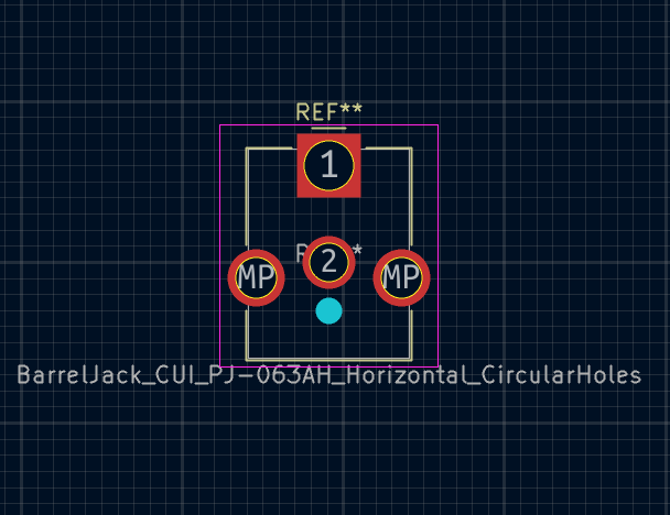

The easiest way to find out what you need is to surf through the Kicad libraries, find a footprint that has examples of what you require and right mouse click to see the Properties of the pads you require and how Kicad deals with this.
An easy way to view the example you choose, and use it as a reference, is to copy/paste the example into the footprint you are creating beside your existing effort, then delete the example when your footprint is completed.
Here is an example from the Connector_Barrel_jack library:
Although it is an entirely wrong footprint for your use, it shows:
Electrically connected pads
Soldered copper pads for mounting.
Non copper, isolated mounting pads.
Right mouse select each type of pad, open their properties and read the pad properties.
Don’t forget to place your Courtyard, Fab & Silk lines. The widths of these can also be established from the example you find.
