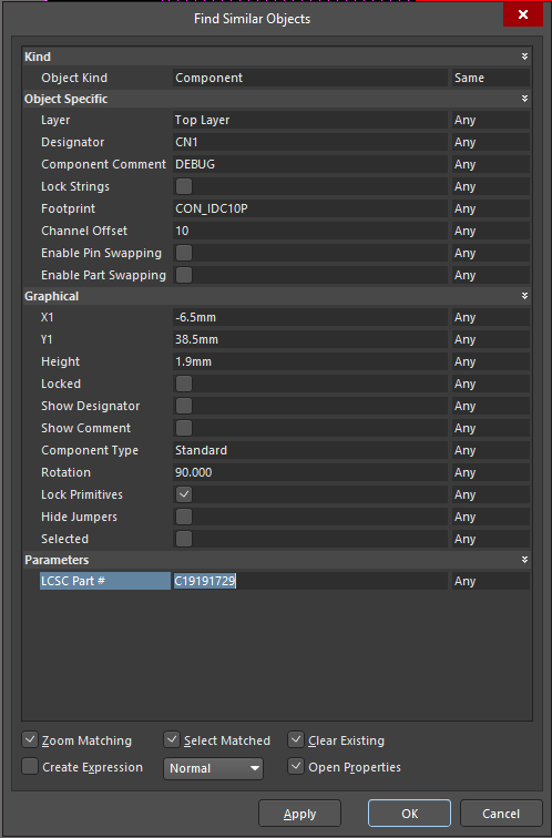

With Altium there’s a very powerful option to right-click an object and do a ‘find similar objects’. What you get is a popup with all the properties of the object and per property the option to find same, different or any objects with this property.
For example:
  1. I want to change all References for symbols on the top overlay to a mechanical layer. In Altium I right-click the Reference, select: TopOverlay: Same. Now all References are selected and I can change the layer in the property box.
  2. Or: I want to delete all traces outside of a selected group of traces: Right click one of the selected trace, select: Selected: different. Now all traces are selected and I can press delete.

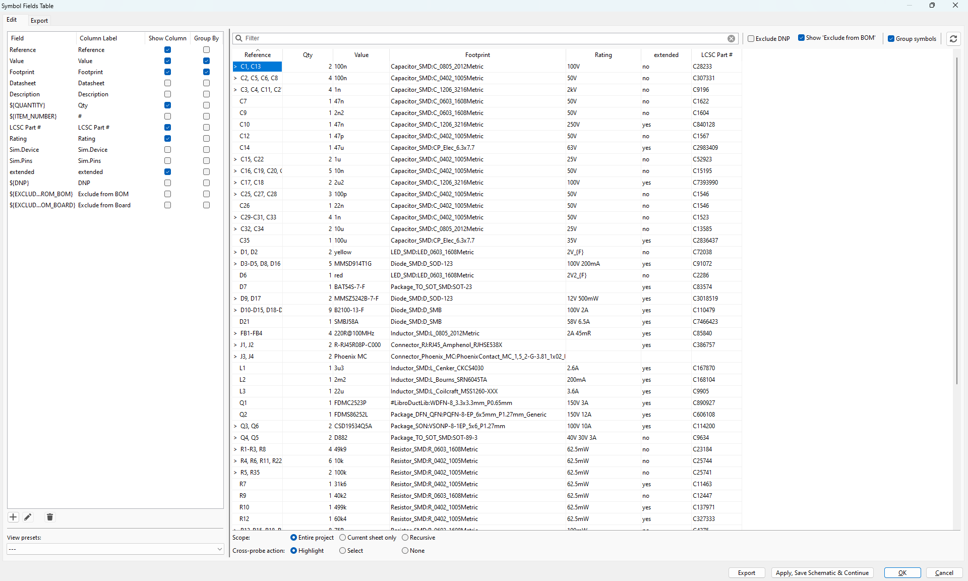

The closest thing in KiCad to this is the symbol fields table which you can sort by different columns:

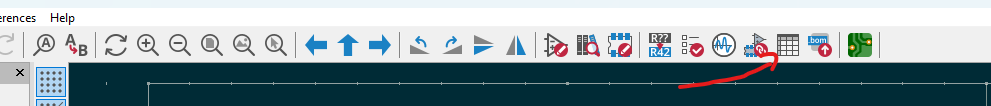

You find it here:
There is also this thread about the same topic: "Find Similar Objects"
And this post about feature requests also has something like this: What feature are you most looking forward to in Kicad v10? - #48 by schlabs
I tried to use the symbol fields table but it didn’t let me select the References field only of the symbol in the PCB editor.

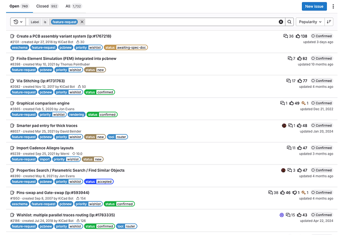

Here’s the relevant one to vote for: Properties Search / Parametric Search / Find Similar Objects (#8390) · Issues · KiCad / KiCad Source Code / kicad · GitLab

I added my upvote and I see it’s a popular request (#7 in the top 10 requests) :+1:
Is not the same thing. “find similar objects” only select. So in propierties you will find all common fields and do everything that you want. For example:
  1. Select all strings with Arial 10 and change it to Times.
  2. Select all resistors and change the library symbol to capacitors if you want
  3. Select only labels in red
  4. Select all resistors with NC and mark as NO BOM
The list is big, very big because “find similar objects” not do anything, only select the elements
