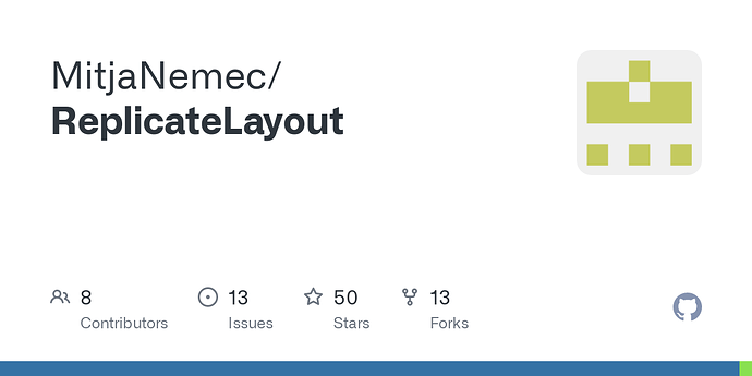

or the replicate layout plugin.
i’m not sure that replicate layout is the perfect match for the job.
The assumption on that plugin is that each replica is EXACTLY the same and all the replicas are placed on the same PCB, my impression is that the OP wants to automate the design of different PCBs.
No in the hierarchical sheet you can change the value of the components (just the value).
So you can have the same layout repeated multiple time with different components value.
But yes it’s for multiple copie on the same PCB.

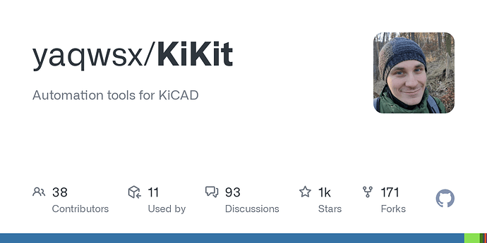

Or KiKit can be used to make a panel of the same design.
