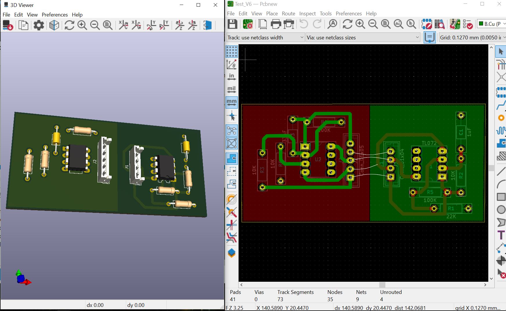

I am running Kicad Version: (5.99.0-7213-g290e73a75), release build on a MacBook Air M1 using Rosetta2.
It works fine apart from Filled zones. I have a two layer board and I try to put a GND plane oh the top layer. Normally it should work around tracks on that layer, but it doesn’t … just puts a plane over the whole board. This is with the default settings.
Anyone know what’s up, this has always worked in the past just fine.

Ahhh, it seems the default behaviour has changed. You have to draw the filled zone THEN you have to press “b” and only then does the zone work it’s way around existing tracks on that layer.
I was used to the old behaviour of creating the zone and it just did it (did not have to press “b”)
I can confirm that if you draw a new zone in KiCad V5.99 it does not initially calculate internal boundaries, and you have to press the b key to calculate them.
To me it looks like a bug, but there may be a small chance the behavior is intentional.
