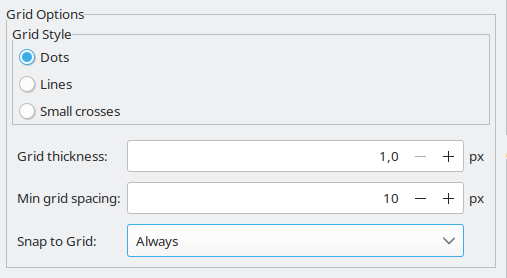

Wouldn’t it make sense to let the corner points also snap to the grid when grid snapping is enabled?
You must have some other KiCad than I :slight_smile:
Do other things snap to the grid?
You can influence grid snapping behavior with: PCB Editor / Preferences / Preferences / PCB Editor / Display Options / Grid Options / Snap to Grid, but this behavior should act the same for all objects. I have no trouble for snapping corners of zones to the grid.
Other things snap to grid.
grafik
EDIT: Guess that grid is too fine.
Well, that would be about 10seconds of work to check on your side, but guesswork and speculation from this side.
Too fine it is. Snapping is working.
