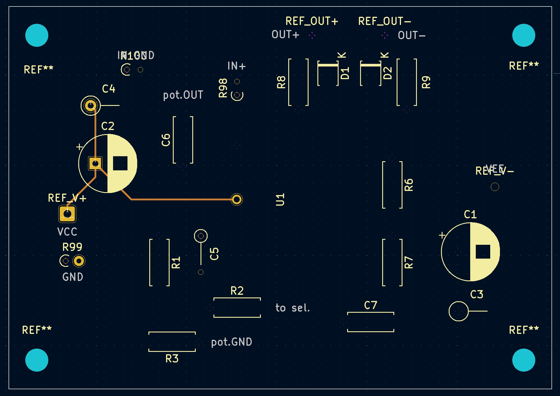

Hello everyone,
I’m new to Kicad (version 6.0.5-0) and I made an audio preamp PCB with OPA. The board will be soldered with only thru-hole components. The voltage supply here is +/- 18v.
A friend advised me to work in four-layers mode and here’s how I distributed them:
  • Layer 1 (top) = audio signal
  • Layer 2 = audio ground
  • Layer 3 = V+
  • Layer 4 (bottom) = V-
    I set all the pads to F.Cu, B.Cu and connected layers and asked for thermal relief which I set to 0.5 (spoke) and 0.5 (gap).

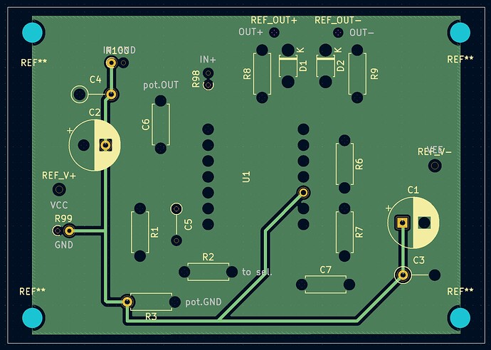

    Now for maximum RF protection I add a filled zone on layer 2 (2nd from top) which is audio GND. Then I read in Kicad doc. that a filled zone can’t be directly connected to any layer and I noticed that in the concerned layer (2) the pads & tracks are “isolated” from the filled zone. So I set one of these pads (R99) as connected to all cooper layers where I will connect the PSU ground to the audio ground.
My questions are :slight_smile:
  • Is it a good way to proceed ?
  • can someone have a look at how I arranged the different layers ?
Then another point : since I will connect wires to the board I add some pads chosen in the connector wires menu but some of them refuse to be paired to the net I’d like : more precisely, the net to which I wish to associate them does not appear in the possible choices of the drop-down menu so I added some resistor’s footprints where I will able to solder my connected wires instead of putting a resistor…
Then a last point : I did not find a dedicated footprint for a TSSOP14 adapter in my footprints library so I drew one in the FP editor (U1 on the schematic) > maybe it’s because my Kicad version is not recent…
Thanx in advance for your help

No, not true, even in such an ancient KiCad version, you can simple edit the zone properties, and then set a net name for the zone. And then after a redraw with b, the zone will connect to all pads with that same net name.

Thank you, you’re right. I did connected the filled zone to some pads but why does it refuse to connect to pad already connected by a track ? In the scrolling menu not all the available pads are shown…

Not Kicad per se, but you probably should not have two ground planes tied together.
Make them both “ground."
You mean the ground tracks + pads ? The pads should be instead directly connected to the filled zone ?
No, I mean that the idea of an “audio ground” and a “power supply ground” is outmoded.
Just use a single ground plane.
You can, of course, use multiple ground planes, but make sure they are well stitched together.

Star grounds are also no longer considered a good design practice.

Here it is

Indeed your question allowed me to realize that I was wrong, either in my analysis or in my diagram.
In my diagram the audio GND and the PSU GND (capacitors among others) are connected by pin 10 of the OPA1679 (third pin at the bottom right) which is the inverting input of one of the 4 channels and by the negative input of the audio signal, so I have no reason to separate these GNDs.
I have the GND on layer 2 and I place a filled zone to “shield” against possible interference. And then I connect the GND of each audio board and of the PSU +/-18v as well as the GND of the +48v for the phantom power supply to the star ground (which is connected to PEN & chassis thru a diode network).
