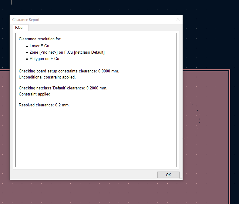

Is your board outline on the Edge.Cuts layer? (It looks like it’s on F.Cu.)
If it’s on F.Cu then KiCad has no way of knowing that you want them to have the same net, so it tries to isolate copper.
If it’s on Edge.Cuts then check Board Setup > Constraints > Edge Clearance.
(The general way to solve things like this is to select the zone fill and the edge and select Inspect > Clearance Resolution…)
Hello, thank you for you response. Yes, board’s outline is on Edge cuts layer. I set both edge clearance and fill area to 0 but still no luck. But I think answer is close since doing an inspection it show Netcalss Default .2mm, please advsie on how to set it to 0 is possible. I assume this will fix my issue, thank you
I have hidden Edge cuts layer so not shown in this picture(white line left from previous) + Board Setup Window
I believe this is my issue, picture after inspection we’re progressing
OK I figured how to set default spacing to 0
It looks much better but still some area is missing coverage…
