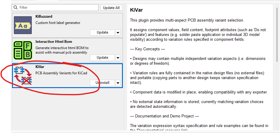

It sounds like you are talking about variants ?
So if you has a conditional “No-Serial” all Components tagged with it would be temp-marked/Masked with DNP so you can generate a PCBA file set that simply doesn’t have the Serial Port and assorted chips/resistors?
That would be useful to me.
OR
are you asking for the foot prints to be removed or something else complicated?
For now use the KiVar plugin . . .
