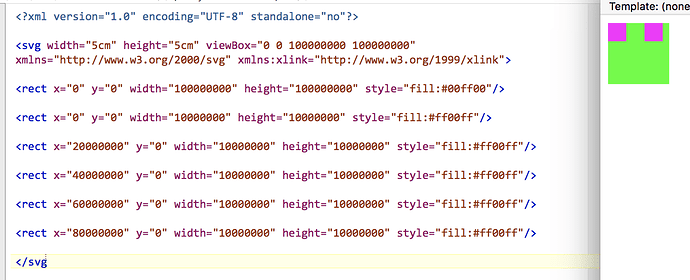

Large scale SVG:
<?xml version="1.0" encoding="UTF-8" standalone="no"?>
<svg width="5cm" height="5cm" viewBox="0 0 100000000 100000000" xmlns="http://www.w3.org/2000/svg" xmlns:xlink="http://www.w3.org/1999/xlink">
<rect x="0" y="0" width="100000000" height="100000000" style="fill:#00ff00"/>
<rect x="0" y="0" width="10000000" height="10000000" style="fill:#ff00ff"/>
<rect x="20000000" y="0" width="10000000" height="10000000" style="fill:#ff00ff"/>
<rect x="40000000" y="0" width="10000000" height="10000000" style="fill:#ff00ff"/>
<rect x="60000000" y="0" width="10000000" height="10000000" style="fill:#ff00ff"/>
<rect x="80000000" y="0" width="10000000" height="10000000" style="fill:#ff00ff"/>
</svg>

You’re mixing units.
Your output graphic is doing what you’re telling it to do. Just need to tell it to do the correct thing.
px = dots and ALL SVG is based on DOTS/INCH, Thus, need to convert from Metric to Inch and it’s best to Not mix units or DPI (you can mix units but, if so, clarify them with unit designator and, don’t hope too much for graphic readers (i.e., Edge, Firefox…etc) to get it right. They’ve gotten better but, not all are there, yet.
Thus, Best to stick with one way of doing it (or go through the PITA of calculating and fixing errors and discovering what’s wrong…)
Once you get your graphics looking as desired (using INCH and PX), then you mess with trying out different approaches.
ADDED: Again, you don’t need a viewbox but, if using one, be sure to get the parameters correct!

Thanks for the input @BlackCoffee. I agree that including cm dimensions and viewbox complicate things but that is how KiCad exports SVGs so I’m trying to troubleshoot why they look broken with those parameters.
I’ll keep tinkering on it and in the mean time accept KiCad SVG output requires additional post processing for my needs.
