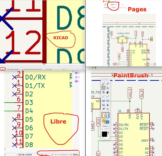

In Kicad’s Schematic:
File>Export_Drawing_To_Clipboard
In whatever software you use, Edit>Paste (it will grab the clipboard content). Thus, no need for Plotting or saving other types…
In Libre, new document (any type) Paste. Result is okay but, a bit fuzzy and not sharp.
In KeyNote or Pages (Mac’s default Office software), document, Pasted - it’s perfect! Screenshot below… So, software does affect immediate usage.
Both are Zoomed to 1:1 - don’t be misled by the visual size, my Kicad window is smaller than KeyNote window…
Maybe so, but this screenshot is not a fair comparison, because of difference in scale. Below I took two pieces from the big screenshot and magnified them 4x. KiCad has always had some trouble with pixel rendering anti-aliasing and other processing, and this gets progressively worse when zooming out. The rightmost ā€œKiCadā€ (LibreOffice?) part of the screenshot is zoomed out further, and it is getting into the area where KiCad’s text processing is becoming problematic. Notice the differences between all the letters ā€œDā€.
I think you’re mixing resolution of my screenshot for Posting, versus actual Images in the App’s (Kicad and office software…)
It’s fair to say there are going to be differences. Below screenshot shows 4 images… In all cases, the quality is good
