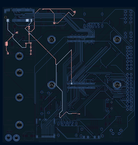

I’m working on a 4-layer PCB in KiCad and have trouble with the export.
In the JLCPCB viewer, only the drill holes and a few traces are visible – most of the copper layers and routing don’t show up correctly.
Zones are filled, DRC is clean, and everything looks fine inside KiCad.

The archive don’t seem to contain any exported files, only the project files.
Here is the transfernow link with the production files:
btw, your power traces are too thin:
Also your 5V input seems to be connected only to U3 pin 111 (VBUS_EN), not to +5v.
Also you usually want to keep your high-speed signals clear of other signals and each other:
And there’s no ground return vias for high-speed signals.
You didn’t seem to follow any layout recommendations for DC-DC converters, it won’t work:
There’s resistors under J1, also how were you going to plug it in?
Does JLC support 0.125mm via holes?
Don’t check any checkboxes in “Plot on all layers” when plotting. Every checked layer there is plotted on all layer.
