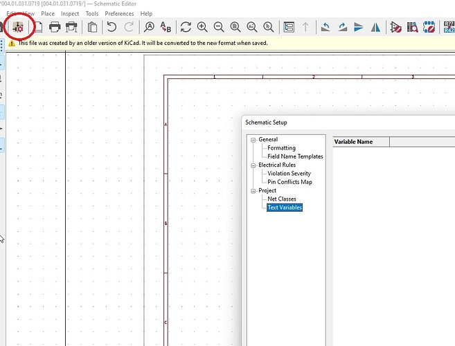

I want to add two new fields: Designer and Reviewer. I might use the keywords ${DESIGNER} and ${REVIEWER}. But where do I input the actual values (in my case, the names) so that they show up in the custom created block? Since they are not available for input in “Page settings…” in sch. or layout editor.
You can enter variables in Schematic Setup.
Thanks. I tried but it didn’t work out for me. Please see attached images for reference. The issue is that {DESIGNER} and {REVIEWER} shows as DESIGNER and REVIEWER respectively, regardless if I add them in the list of Text variables.
Hi HSPalm.
AFAIK, you cannot include text variables directly in the Drawing Sheet Editor. There is a workaround: Use “Page Settings”
You are absolutely right: variables do not work in *.wks files…
