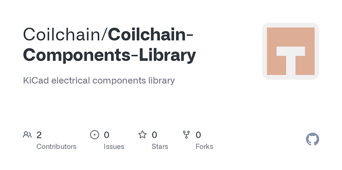

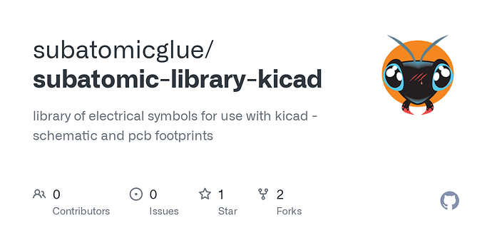

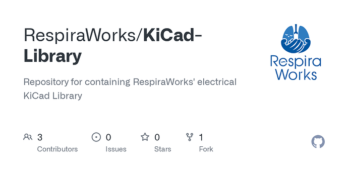

If you go to:
https://devbisme.github.io/RepoRecon/
And then select the KiCad “topic” and type in:
description:electrical library
you find 3 libraries:
