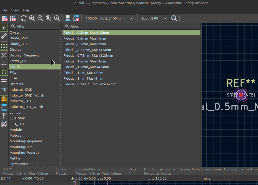

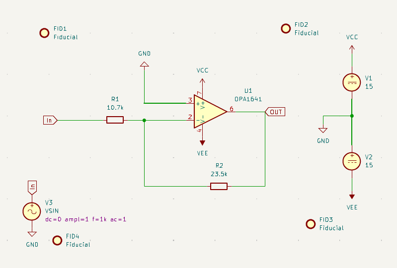

There is a library with fiducial footprints in KiCad. So you just have to assign a footprint to the symbols, just as with any other generic symbol (Resistors, Capacitors, Connectors, etc).
The footprints for Fiducial are in /usr/share/kicad/footprints/Fiducial.pretty/

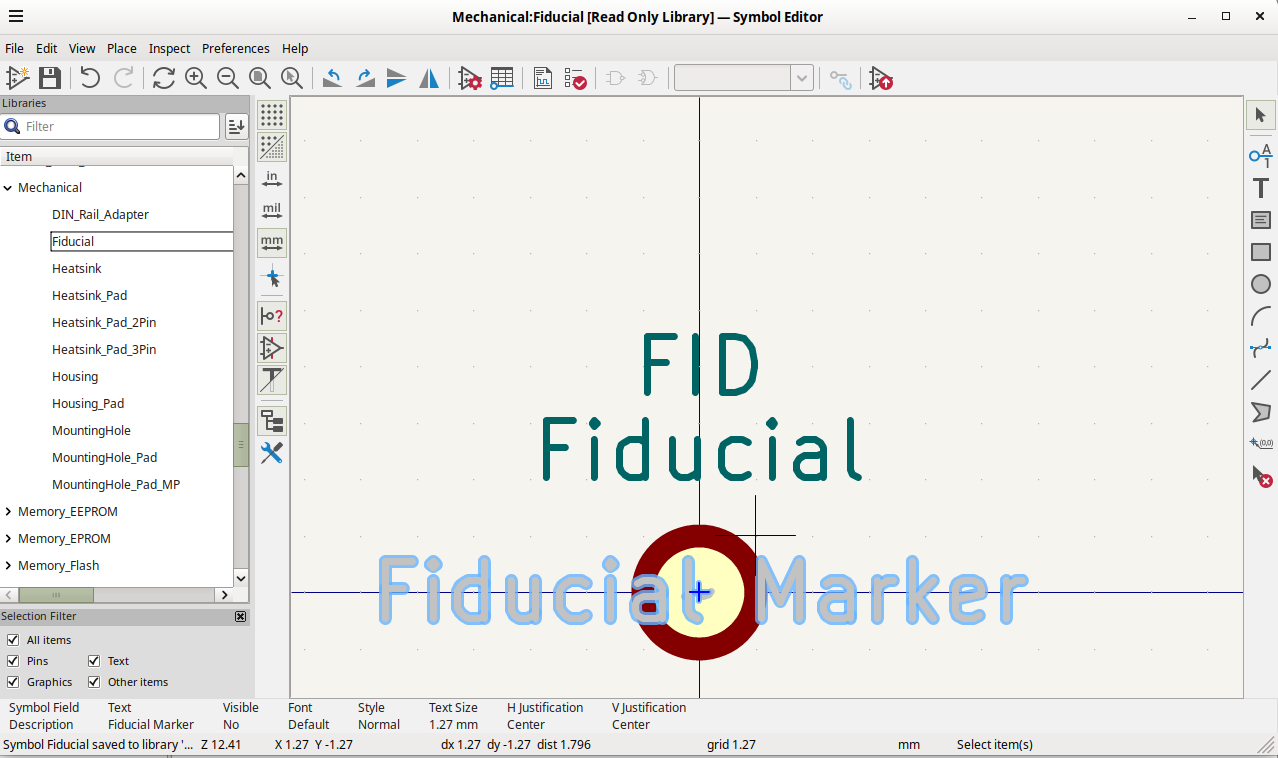

When I edit the symbol for Fiducial in schematic in symbol editor, there is no option to open the footprint editor and edit its footprint. Usually, for all symbols in symbol editor, there is an option to edit the footprint in footprint editor. This Fiducial symbol is different. Here is the symbol in symbol editor.
For me (KiCad V8.0.9) it’s just like any other symbol and footprint, and the fiducial footprints are in the “Fiducial” library. Nothing remarkable at all.

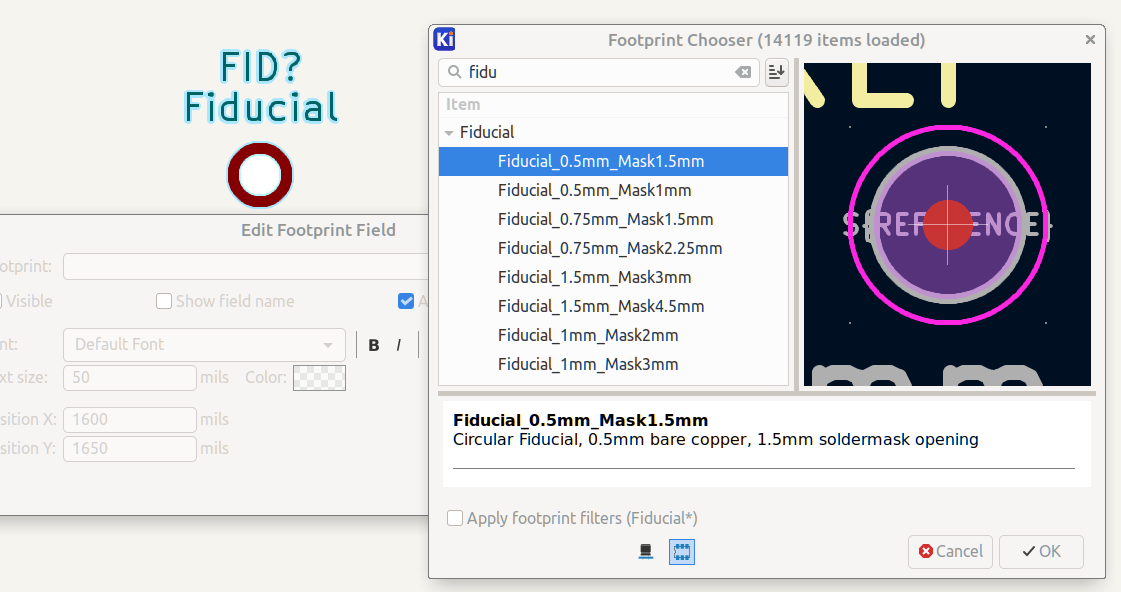

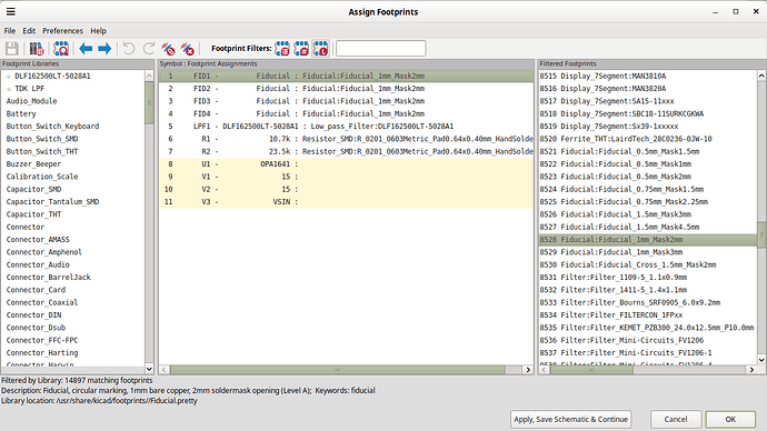

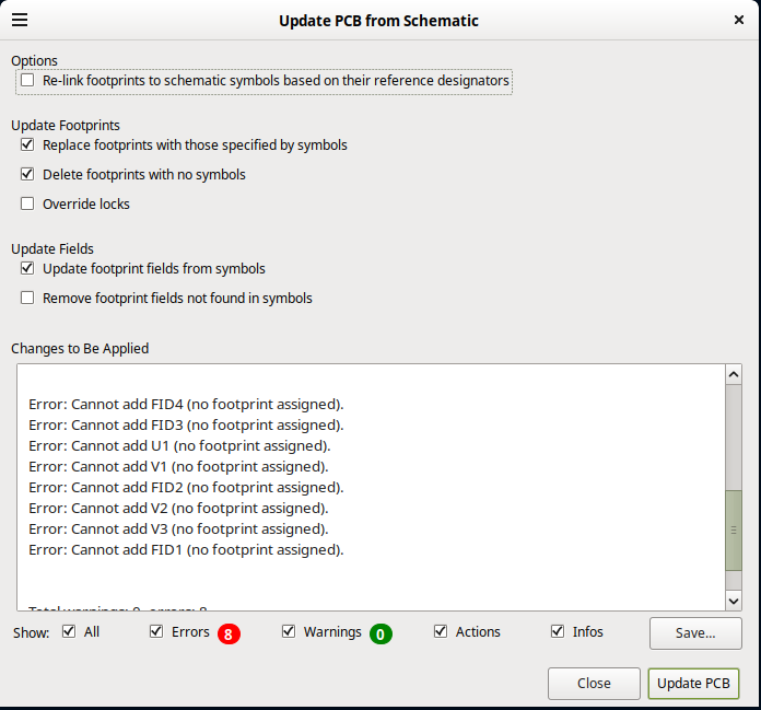

It seems there is no generic footprint for the symbol Fiducial. There are several Fiducial markers of different sizes and they are just selected like resistors or capacitors or inductors. Here is the place where footprints of Fiducial markers are assigned. In Schematic editor: Tools→ Assign Footprints.

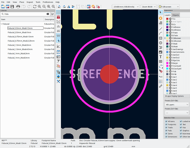

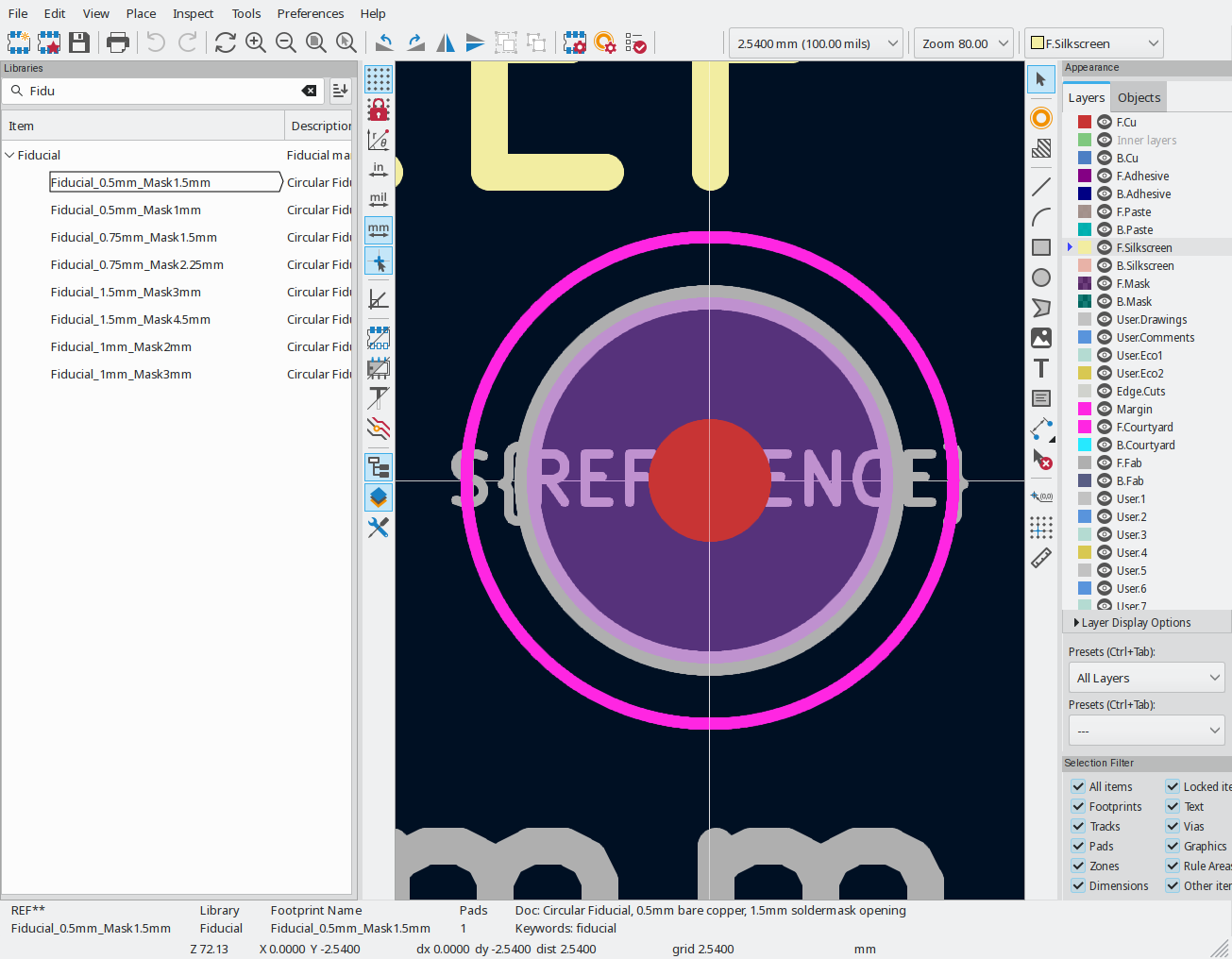

An important thing to do is that Footprint library of Fiducial should be added in Footprint editor. It is not included with a new installation of KiCad.
The path is File–> Add Library –> global in Footprint editor and select Fiducial.pretty folder.
The 3D model looks like a cylinder and has length which far exceeds the thickness of a PCB. This 3D model for a Fiducial might be invalid because unlike 3D models, it is a throughole on the PCB that is filled up. Changing its pad length to 0.1mm might help to view it from one side of the board.
