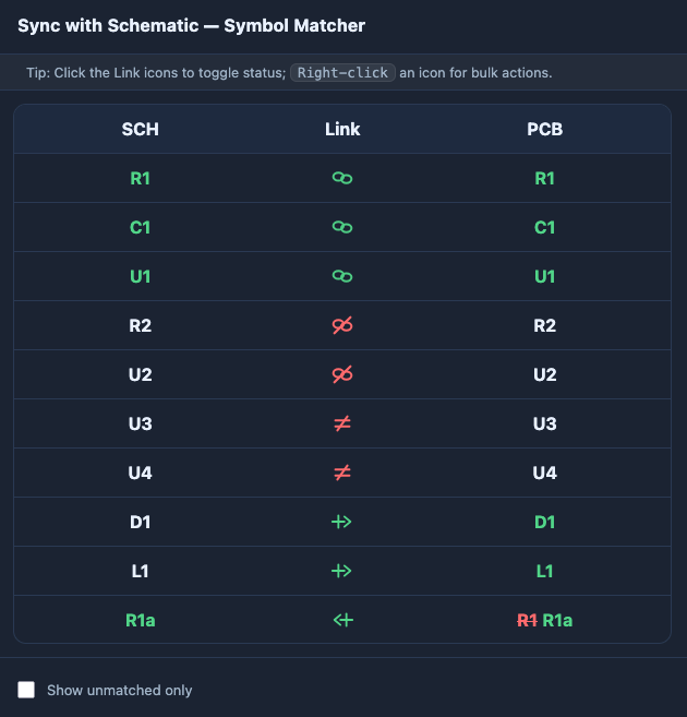

I think it’s not hard to come up with a better and more user-friendly matching flow which solves all mismatches either by prompting or default setting.
Symbol ID match > OK
Symbol ID match but properties don’t > (prompt for) update
Symbol ID exist at SCH but not at PCB. Is reference designator present at PCB?
  • yes > (prompt for) update
  • no > (prompt to) add to PCB
Symbol ID exist at PCB but not at SCH > (prompt to) add to SCH. Is reference designator present at SCH?
  • no > (prompt to) add to SCH
This way syncing can work both ways easily.
I made a quick demo to show how things can be easily and very user friendly solved:
KiCad - Sync with schematic

Rather than re-litigating the cause, I’d like to discuss a design that could make this safer and more intuitive.
Proposal: unified two-way sync (SCH <> PCB) dialog
Mockup: https://codepen.io/Rolf-Nooteboom/full/JoYpGgG
Goal: One command: Sync that makes symbols / footpatterns match, direction-agnostic. Quiet when the mapping is deterministic; surface a dialog only for conflicts (think Google Drive/Dropbox sync behavior).
It auto-matches parts by current IDs. If those aren’t available, it uses simple rules (reference/ value / footprint) and shows three clear lists: missing in SCH, missing on PCB, and conflicts, so you can link, choose SCH or PCB, or park conflicts.
Looking for feedback on:
Are the following rules sufficient?
  • ID not linked > Link (default)
  • Not matching symbols > update PCB / update SCH
  • Not present on PCB > add to PCB (default) / remove from SCH
  • Not present on SCH > add to SCH (default) / remove from PCB
Any edge cases?
Would “auto when deterministic, prompt on conflict” be acceptable?
Happy to iterate the mockup based on your input. :partying_face:
